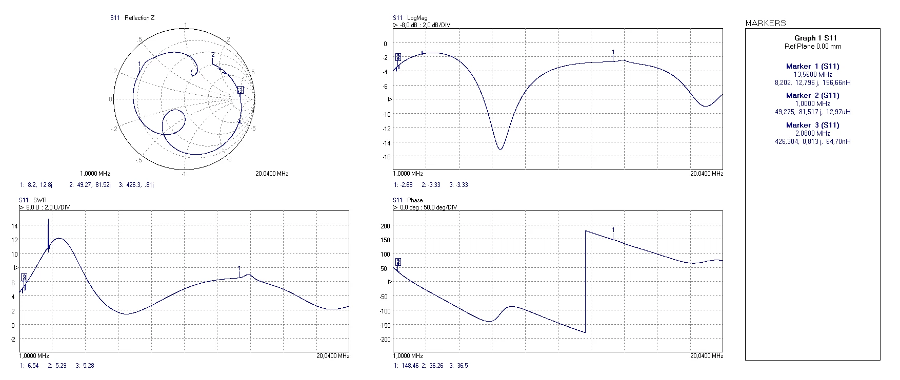

 Hello everyone,
for my project I am using the X-Nucleo-NFC08A1 board. In addition, I am using an external antenna that I operate differentially. The antenna is connected to the board via an SMA connector. I know that I should also adjust the matching network to the antenna. For this, I wanted to use the ST25R Antenna Matching Tool, but I have a few problems determining the appropriate antenna parameters. I have also already read out the antenna via a VNA. :
The aim of the design is to match the antenna with the matching network to 50R at a frequency of 13.56 MHz, right?

Your antenna is quite de-tuned. The resonance frequency of the LC tank is too low.
I assume the parallel capacitor is too big.
There are dedicated antenna design appnotes for each product.
For example AN5276 for the ST25R3916B. It describes how to do the antenna matching and what aspects to respect. The antenna matching tool provides the required calculation for the products and different topologies (differential, single ended, single ended with cable (50Ohm)). Additional information can be found here:
https://www.st.com/en/nfc/st25r3916b.html#documentation
To follow the process described in the antenna design application note, you should first disconnect the antenna and measure its parameter. Afterwards you input the antenna parameter into the tool.
The target matching impedance is setting the output power / power consumption. It is chosen based on your application and requirements (available power budget).
BR Travis

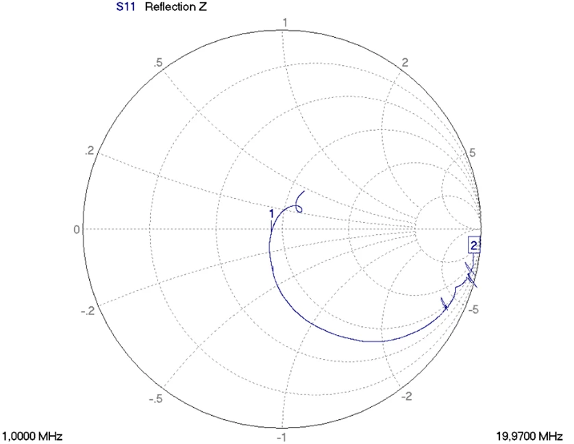

first of all thank you for you're answer. The picture shows the characteristics pf my antenna and its selfmade, so I dont have any data information. I followed the application notes and tried to use the tuning circuit calculator but the self-resonance-frequency is to low and I am not able to calculate the values of the other Devices. I tried to change some values to see what happens. The best version I got was this. Kepp in mind my antenna is connected to the circuit with long cable.
I changed C305 and C308 from 680pF to 330pF and added  an extra resistor with 22 Ohm. Am I on the right track or have I neglected something? I try to do some fine tuning to get a better impendace. I also want to ask if there is a problem with the extra resistor because I will lose some power on it ?
Best Regards

Additional with the help of the VNA i measured the antenna with the cable so the first picture of the post shows boath together.

Hello Travis,
thank you for you're time and the detailed explanation. I tried single ended and it works very good. It's just some fine tuning. I would like to compare different antenna with different matching curcits. Do you have any tips for doing a comparrison ?
