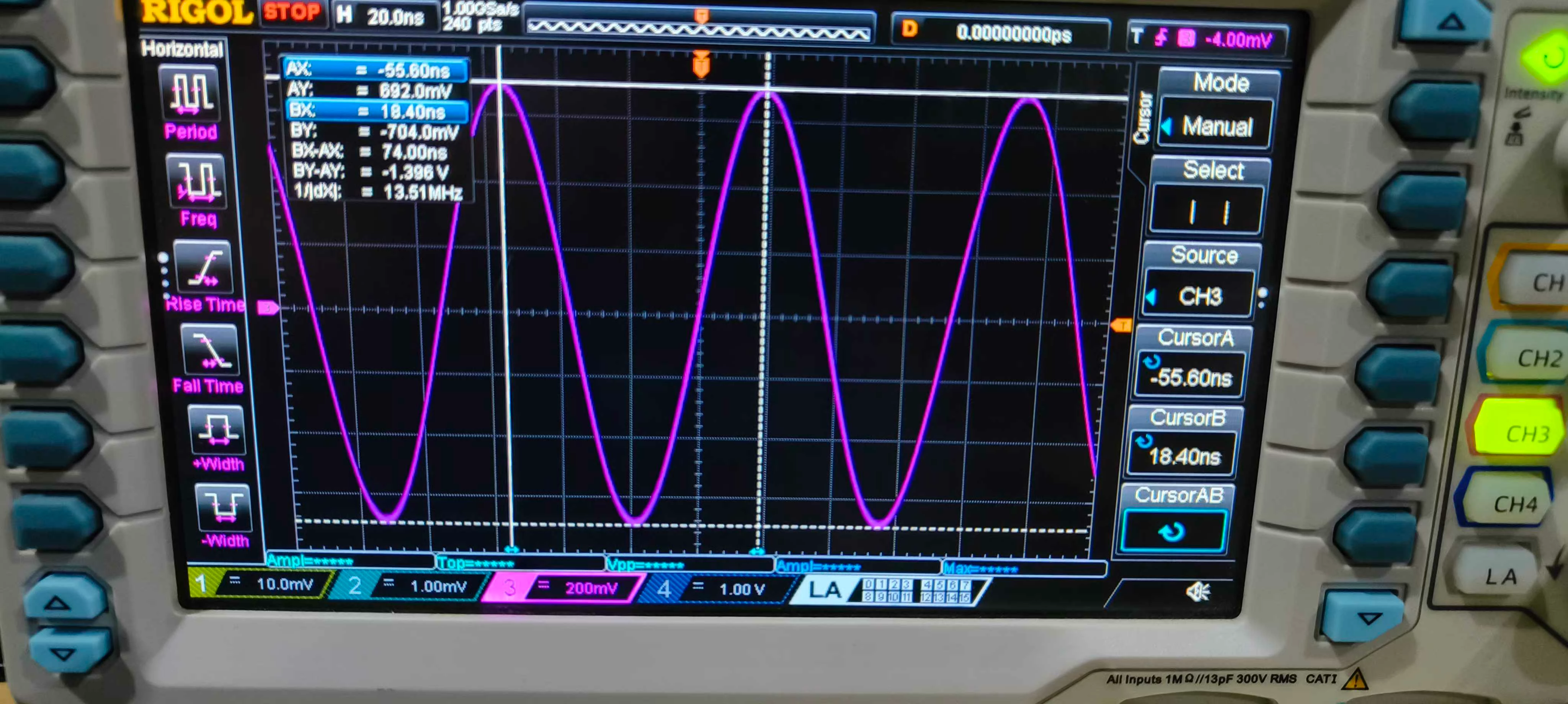

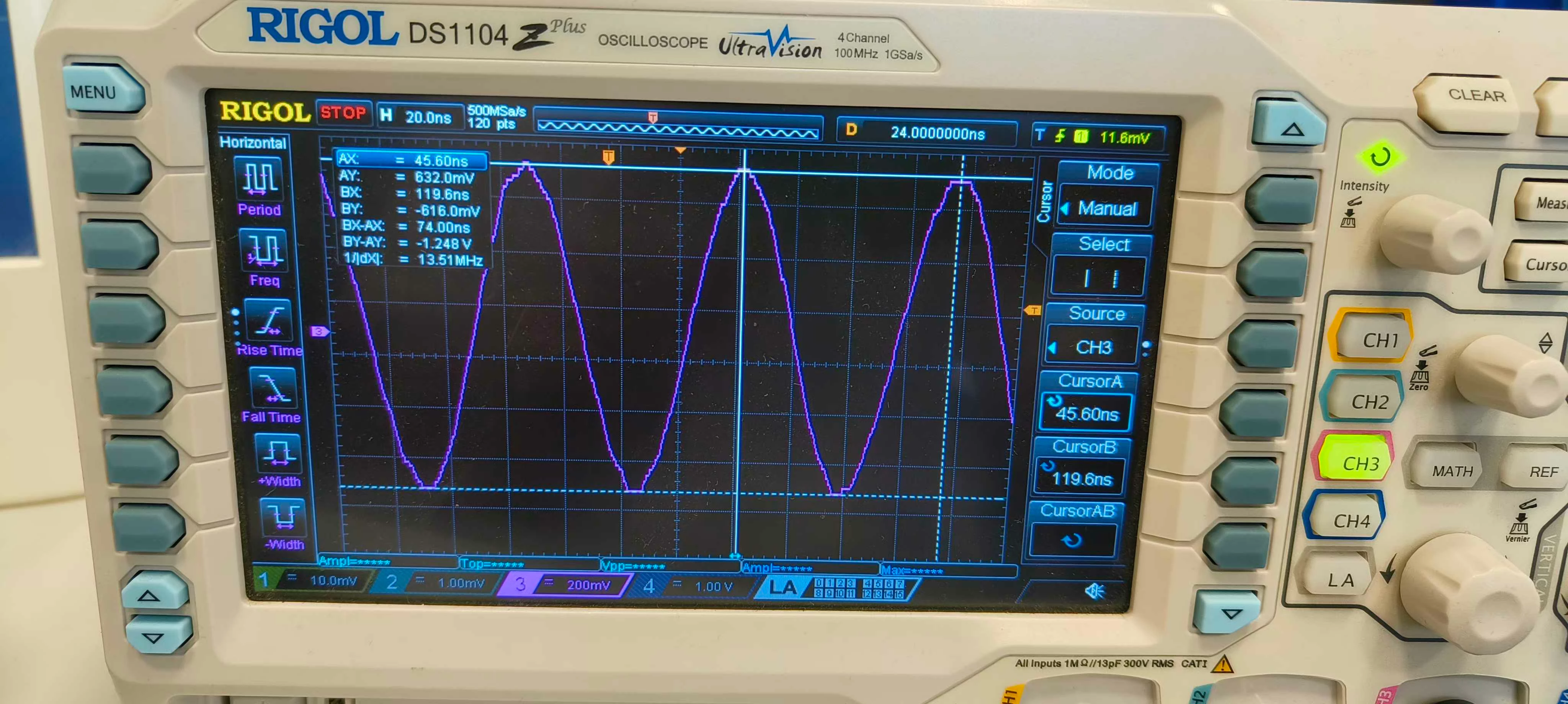

    We tried probing the RF field and were able to pickup the 13.56MHz carrier and at both the sites the we observe no difference. Also dc level at ST_R0 is same that is 7.8V at both the sites. We also probed the 5V output from the adapter and found the voltage is stable and ripple is around 30mVpp.
    1. Field pickup at the office site
    2. Field pickup at the Production site

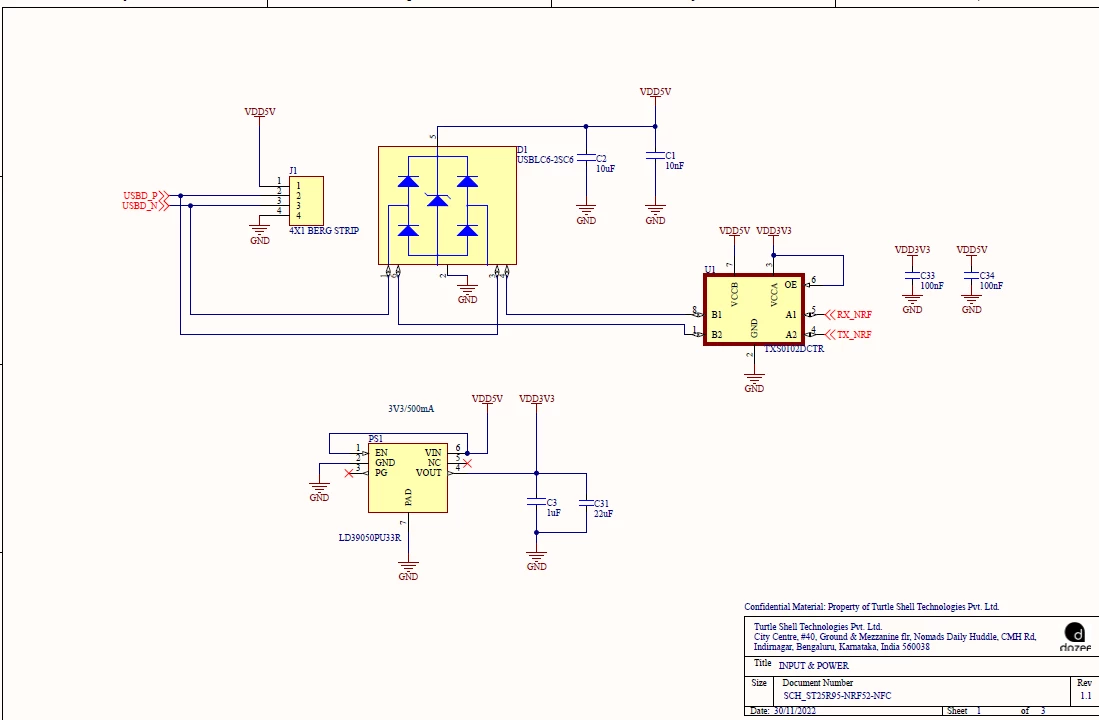

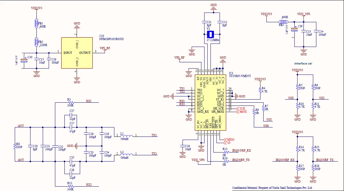

    Sharing the schematics for your reference

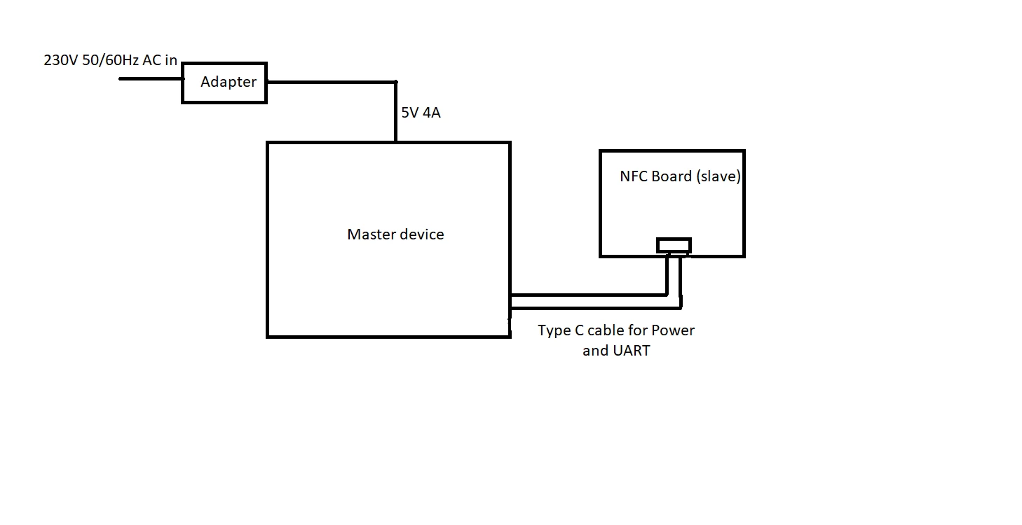

    Attaching a rough block diagram for your reference, Please suggest accordingly
    Thanks in advance,
