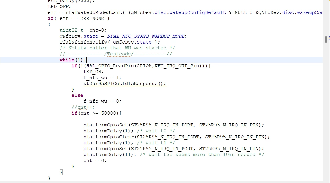

/** PROJECT: ST25R95 firmware
* $Revision: $
* LANGUAGE: ISO C99
Even Tag reading and all that functionality works fine.
I'm using Lib function st25r95CalibrateTagDetector that is called inside rfalInitialize for calibration.
If I set WU Control value = 0x38 0x01 as per recommended, with that it is not woke up by even providing Low pulse on IRQ_IN pin as well as by Tag detection also not work. But if I set it by 0x79 0x00 recommended in Application note AN3433, it is wake up by providing Low pulse on IRQ_IN pin as well It woke up without Tag if value of gRFAL.wum.cfg.indAmp.delta = 4U as per Lib, but if I change it from 4U to 8U, It is not wake up by Tag detection even I tap Tag on antenna.
On my side gRFAL.wum.CalTagDet is 0x54 in free air and with Tag also. Some time it returns 0x50 when a tag is on the antenna.
Thanks.
