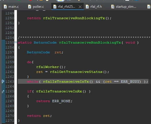

Im trying to get the Pollerexample with the ST25R911b-DISCO working
i attached a Picture that shows where.
It just stared the programm an had no connection to NFC devices befor.
How can i get out of ERR=BUSY ?

HI Titus,
correct. And I wanted to write "your", not "our" above (edited).
In case you are still using our sample timer.c then I would suspect that platformGetSysTick() is not operational.
Best Regards, Ulysses

Hi Titus,
not sure what you have done. Have you ported to a different controller? Then it is likely a porting issue in Timer/Interrupt handling.
Please share some more description on what you have done and what you observe!
BR, Ulysses

the rfalTranciveState gives me "RFAL_TXRX_STATE_TX_WAIT_GT"

likely your porting of timer (platformTimer*()) is not correct.
