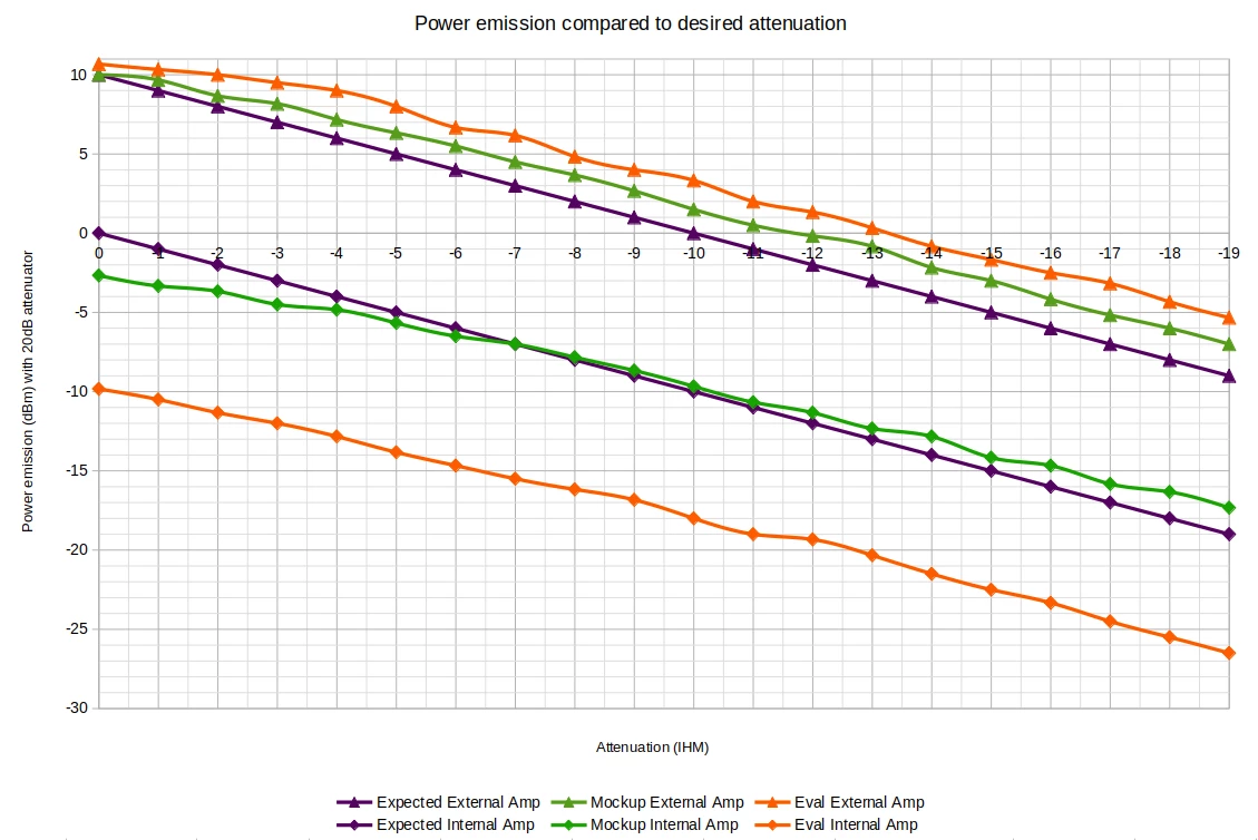

We have redone the output power measurements. We use a spectrum analyser connected to the output port and we measure the power output during a tags inventory of several seconds/rounds (Europe profile):
With our modified HPEV-board:
  • With the Internal PA, at 20dBm (Output level 0), we measure 17.33 dBm
  • With the External PA, at 30dBm (Output level 0), we measure 30 dBm
With the non modified HPEV-board:
  • With the Internal PA, at 20dBm (Output level 0), we measure 10.17 dBm
  • With the External PA at 30dBm (Output level 0), we measure 30.67 dBm
You can find below the measurements we did. The "Eval" board is the non modified one. The "Mockup" board is the modified one.
Here is our spectrum analyser configuration:
  • Center freq: 866,9MHz
  • Span: 10MHz
  • RBW: 100kHz
  • VBW: 300kHz
  • sweep: auto
We are surprised by the results obtained with the non modified HPEV board. Is there an issue in our test procedure, test set up, or with our evaluation board?
Best regards,
Thomas.

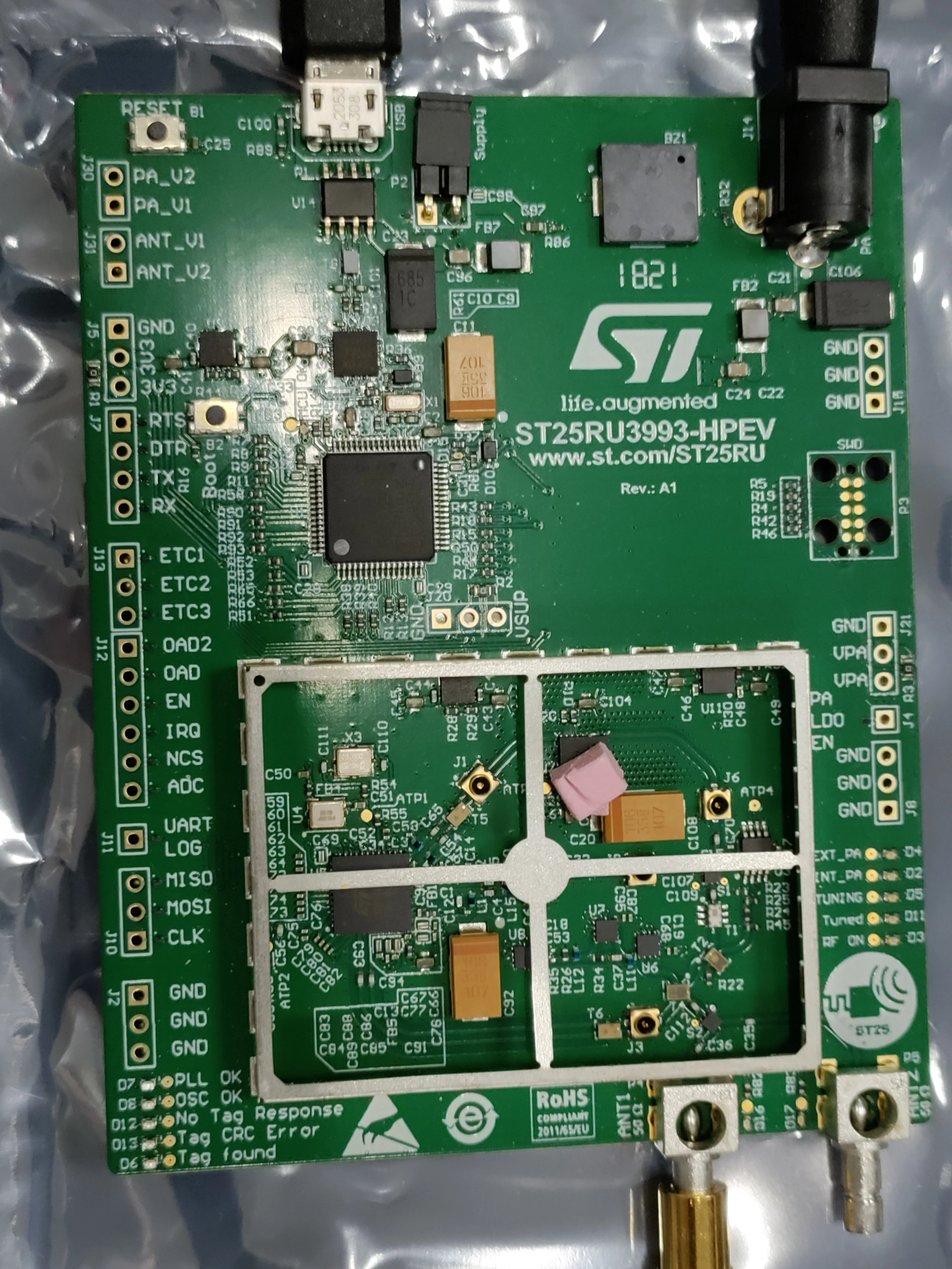

Bart Herse
Visitor II
April 27, 2022
Hello Thomas,
with the information provided it is hard to tell why the EVAL board shows a lower output power.
I suggest you share screenshots of the Reader configuration/settings dialog and the register map.
A high-res. picture of the board itself helps as well.
To narrow down on the source of the problem you could measure the internal PA output power at J9 which is located between the Balun and the PA switch. Check if the output power here is at an expected level.
With regards to your question from an earlier post:
"Can you explain why we still have a residual signal on an antenna when powering the other one ?"
--> the RF switch at the antenna ports does not have an infinite isolation between the two switch-ports. That is why the "inactive" antenna port still shows some low power level.
Cheers,
B

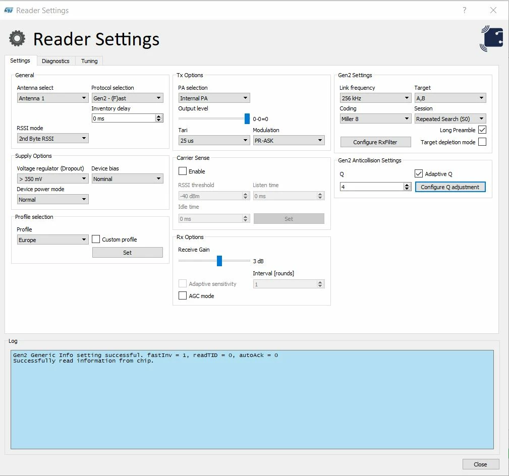

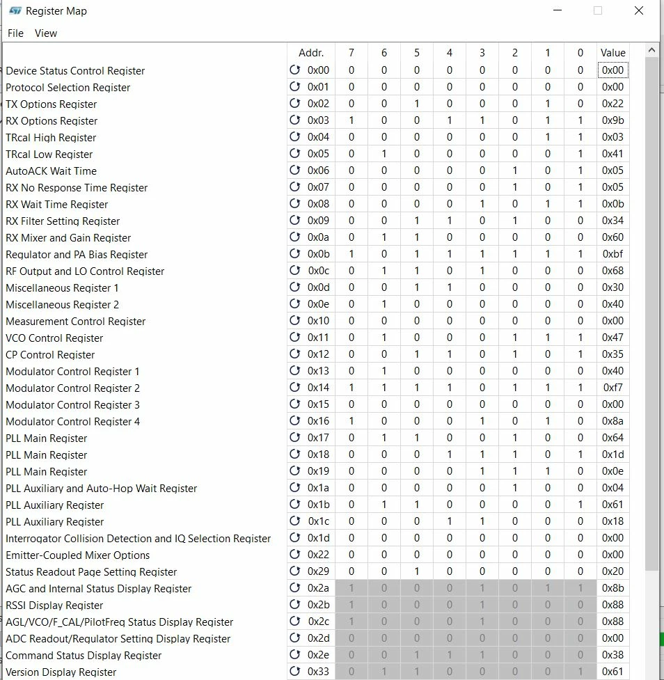

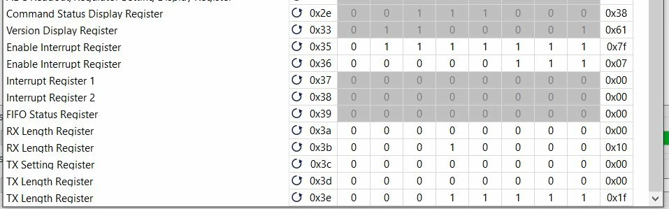

TCrav.1
TCrav.1Author
April 29, 2022
Hi Bart,
Here are the screenshots you needed.
We don't have any test adapter (MS-156-HRMJ-2) to measure power at J9, can you help us with what we have provided so far ?
Thanks,

Bart Herse
Visitor II
May 5, 2022
Hello Thomas,
thanks for sharing this information.
Nothing in the settings of the reader would explain to low TX power levels in your measurements.
With regards to measuring the power at J9:
Can you check if any soldering/assembly problems are apparent on the components between the reader IC, J9 and S1.
If no obvious issue can be found we should discuss sending-in the board for a check.
Can you confirm that no modifications were done on the board?
Cheers,
B
