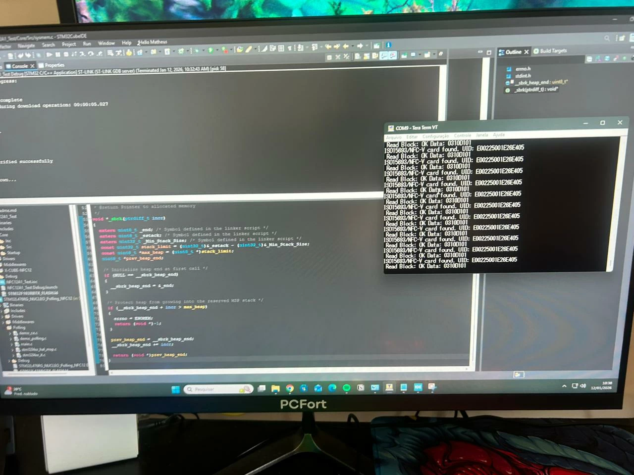

My first steps were to use the library's polling example to do an initial anchoring test between the tag and reader, which worked well. My current goal is to expand the polling example to work better with Energy Harvesting, and thus achieve higher voltage measurements to consolidate the idea of powering chips with it.

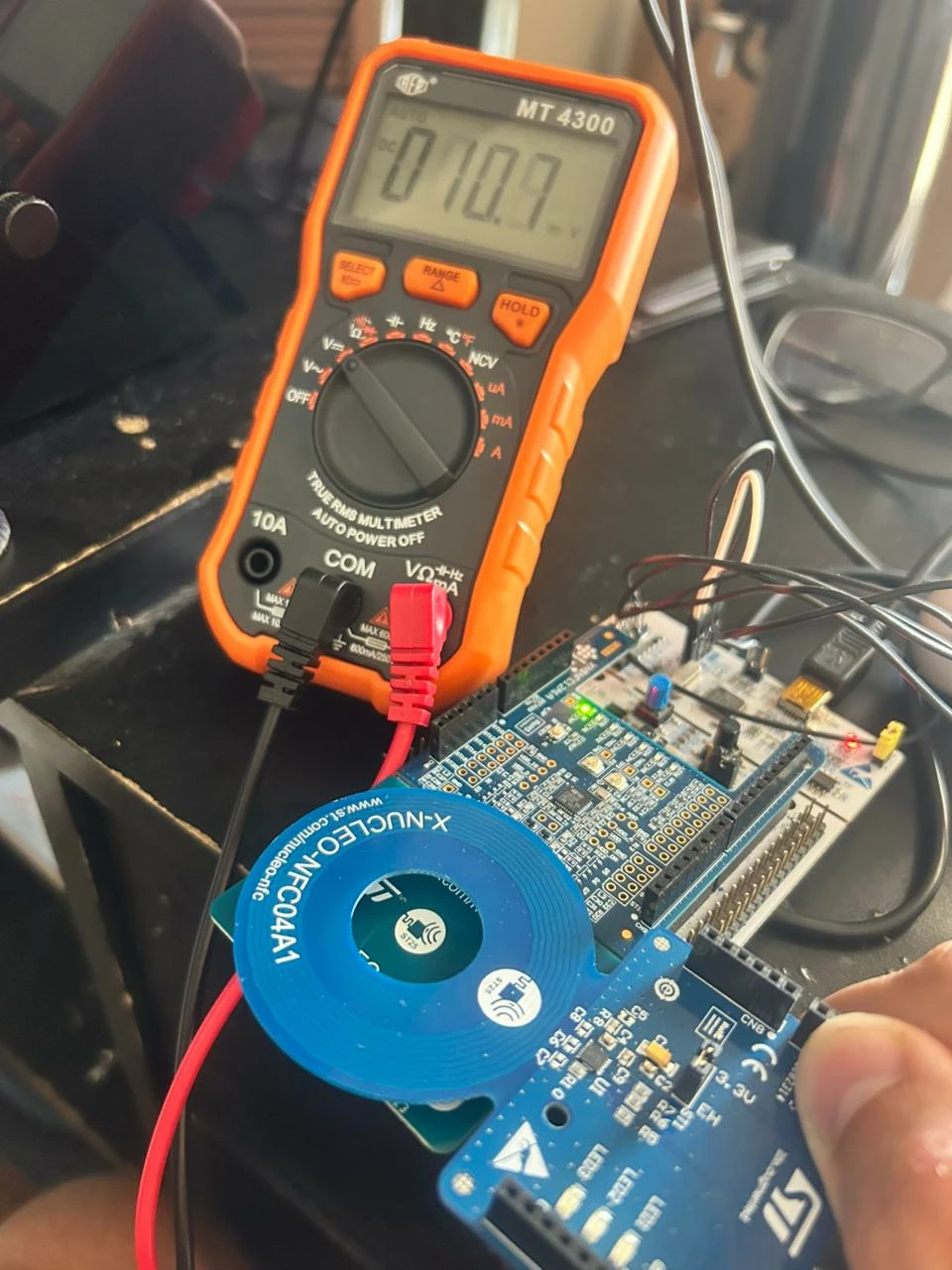

I made an improvised measurement on the EH pin of the x-core while it was running the polling example on the NFC12A1 x-core, to get an idea, and I reached 10 mV on the EH pin.
What can I do to increase this to perhaps 1V, for example? Would it be possible to reach 3V in EH?

JL. Lebon
January 12, 2026
You should already get more than 10mV on EH with the standard ST25R300 setting (I'm expecting some Volts not mili-Volts). So, I guess there is something wrong to fix before trying to tune the reader.
How and where do you measure EH?
How did you enable EH in the ST25DV04K? (it is disabled by default)

 These codes are running on my own board and not on the X-NUCLEO-NFC04A1, as I wanted to test my entire system with Harvesting. The reader continues to be the X-NUCLEO-NFC12A1.
I realize that I have a big problem with my tag antenna, since it only works when it is touching the reader antenna. One of the problems I identified in the antenna is that its inductance does not match what was expected in the ST25DV. To correct this, I will add a 220pF capacitor in parallel (between AC1 and AC0).
JL. Lebon
JL. LebonBest answer
January 22, 2026
Are you enabling the EH from the static register (EEPROM)?
I think the ST25DV_EH_Enable_Static function is wrong. It looks like to me that it is setting bit 0 (EH)_EN) of static register EH_MODE to 1 to enable EH. If you look at the datasheet table 40, it must be set to 0 to enable EH. Actually, it is a bit of a trap as this bit is reversed compared to the EH_EN bit in the EH_CTRL_dyn register.
