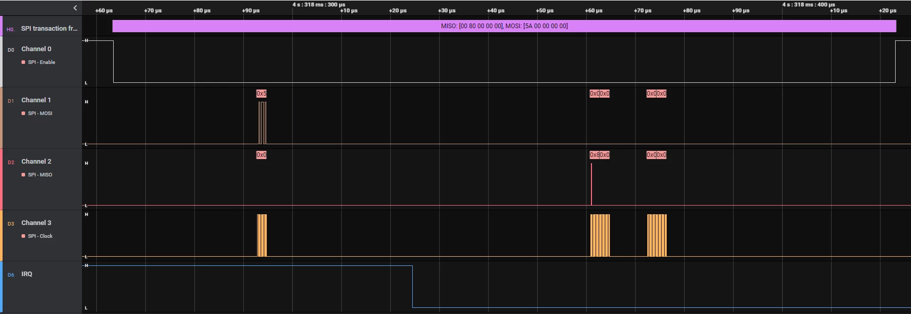

I added saleae analyzer output for working/not working device

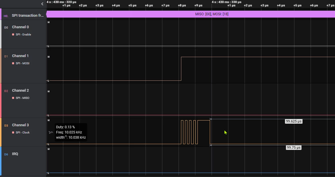

Reviewing the traces I see not soo good signal quality on the signals:
  • Weird signal on IRQ line: going low prematurely and ringing 0693W00000WIIYyQAP.png
  • One time the IRQ line (during init) was staying high 100ms, not handled by ISR

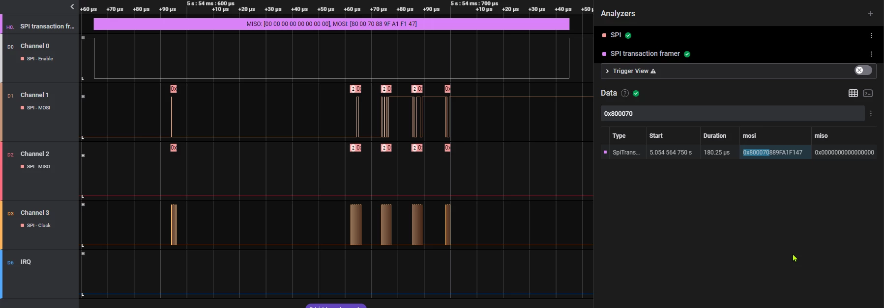

  • There seems to be an issue in your porting as the command bytes in NFC-A ends up wrong on SPI bus:0693W00000WIIclQAH.pngIt should be RFAL_NFCA_CMD_SEL_CL1 (0x93) but ends up as 0x00: 0x800070 instead of 0x809370. This is why the tag does not respond to the select on first cascade level. Please debug the code to see why the 0x93 does not get out.

in above trace it was getting to RFAL_NFCA_CR_SEL_TX with the NFC-A tag. I understand that it will not be easy for you to debug our driver logic. But what you could still do is debugging the SPI driver calls (using logging) vs the bytes observed using logic analyzer.
I assume you will need to first improve the signal quality as observed on the logic analyzer and then look at the data bytes. Ideally you could straight look at the unique pattern as above which was present in both traces.
If this is not possible then I think it should be possible to use a diff tool to see differences in logic analyzer output (exported/sent to terminal) vs logs which you could add to your SPI driver.
