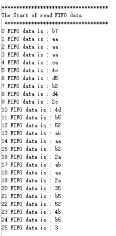

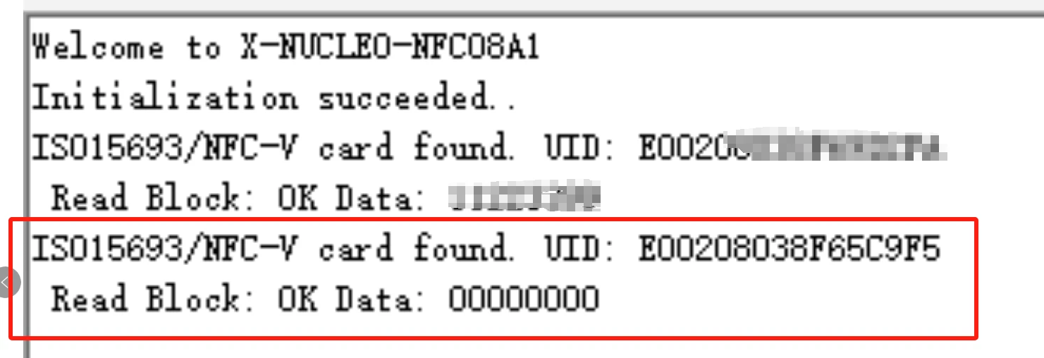

I have a ST25TV tag,The UID is E0 02 08 03 8F 65 C9 F5(8bytes)
I use the board of NUCLE0-NFC08A1 and the demo in NFC6 generated by Cube MX.
I can read the relevant information of the card through the SPI provided in the demo and  than print the UID of the card to the serial port(Figure1),

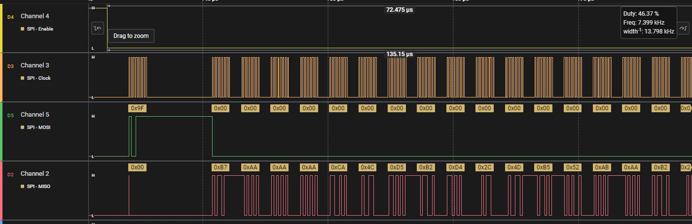

but I am unable to see the waveform related to the tag's UID on the logic analyzer. Could it be because the UID is encoded during transmission?
I cannot find the corresponding UID in the waveform diagram.
How can I obtain the UID by analyzing the waveform?
Figure1:
FIFO data:
waveform:

Brian TIDALBest answer
Sep 26, 2024 2:15 PM UTC
what you see on the SPI trace is the manchester stream between the reader and the tag. This stream of data in then decoded by the FW.
You can decode it by porting rfal_iso1693_2.c in your environment.

Brian TIDAL
