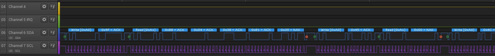

At 3:77ms, I see it read the FIFO status register, which looks like it says only 2 bytes are available. I was expecting more (aren't we getting the UID?). Then it reads 2 bytes from the FIFO, but those 2 bytes don't correspond to what I'd expect. The tag ID is: 04:38:81:EA:F4:73:81

the 2 bytes is the ATQA (44 00 - answer to WUPA) which does not carry UID bytes.
I find in the trace a place where part of the UID is read (the first cascade level (response to 93-20):
0693W00000WHZIRQA5.pngThe reception of this UID bytes is happening at an unexpected place - software seems to have already advanced to somewhere else as it was doing multiple register accesses since the I_rxs. Also after that it does not move on to second cascade level (eg. sending 95 -20)
How does your I2C driver work? Any chance of out of order executions or dropped I2C requests?

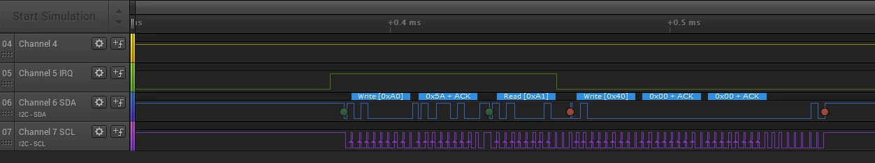

Also the trace is hard to follow due to crosstalk from SCL onto SDA (Here it should read as A0 - 5A - A1- 10 - 00 00 00 (I_rxe), which appears after enabling the glitch filter on SCL (1sampe).
0693W00000WHZGmQAP.pngAnd last tip: Saleae V2 software supports better searching in frames, etc instead of only looking at single bytes.
