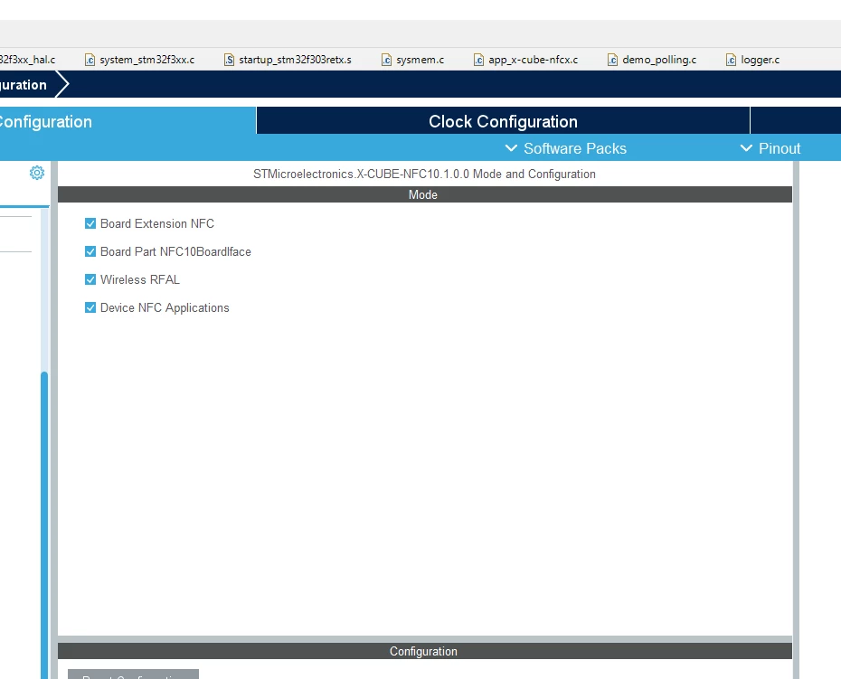

I would like to develop a system using the NFC chip ST25R200 and the microcontroller STM32F303. The main idea is to be able to read an NFC tag, specifically the ST25DV64KC.
As a first step, I plan to test this using the prototyping board NUCLEO-F303 and the NFC expansion board X-NUCLEO-NFC10A1. I'm using CubeIDE.
I'm sure that ST has prepared everything for a simple and smooth integration. Because of that, I'm confused about what I'm doing wrong.
After configuring the pins and integrating the middleware/software in STM32CubeMX, I get errors when I try to compile the code (I haven't changed anything in the generated code).

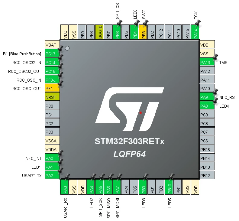

Here is picture with Pins defined:

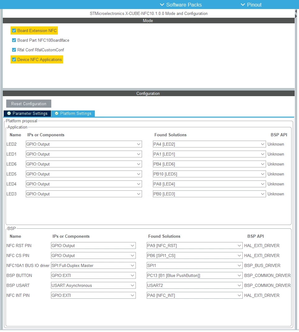

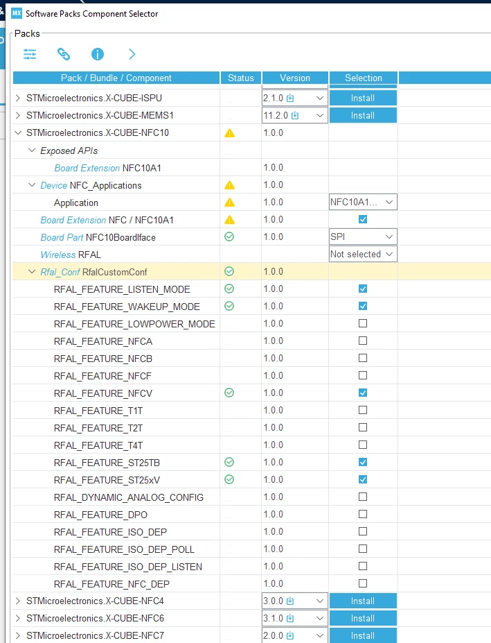

here is Middleware/software package included and set:

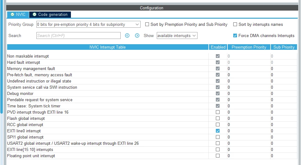

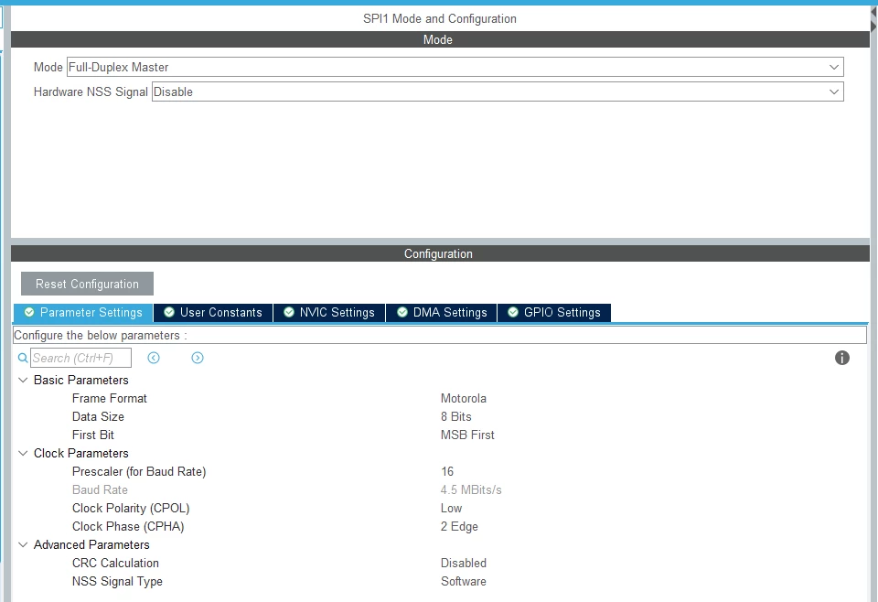

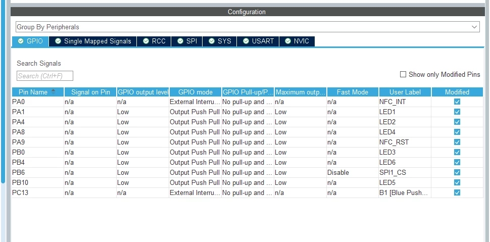

SPI1, Interrupt, GPIO configure:

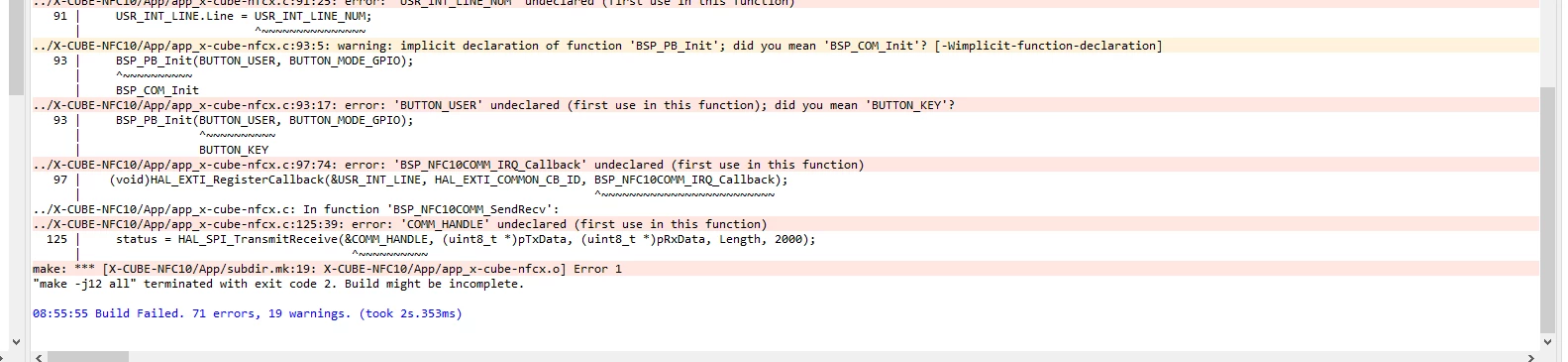

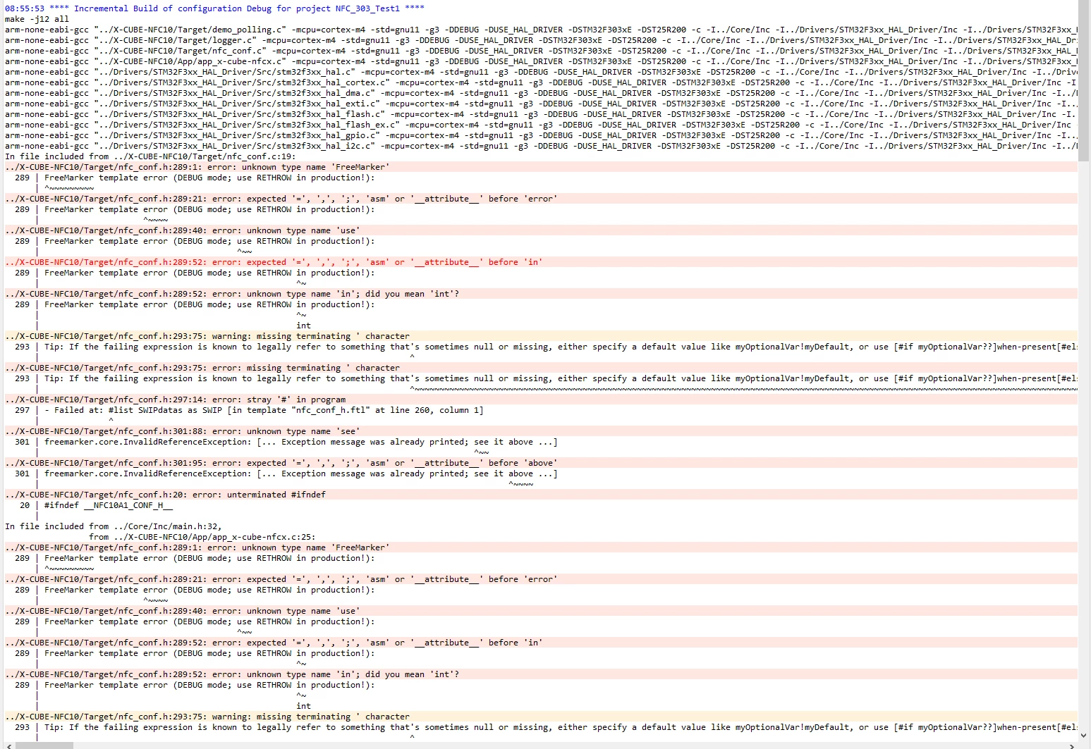

After generating code I go to main.c where I want to compile generated code and get a lot of errors:
Can you please help me understand what I'm doing wrong?

make sure to select an RFAL configuration. It seems not selected in your case:
This should be something like:
See attached ioc file as an example.
Rgds

DIvan.1
DIvan.1Author
May 13, 2025
That solved my problem.
Thank you very much.

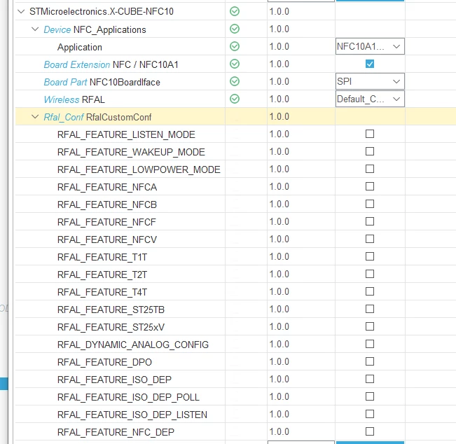

If I want to use NFC-V and allowed energy harvesting for tag (ST25DV64KC)...
1. what is the minimum of the functions I need to use?
2. what of these options I need to use:
I'm a bit sceptical with time spending using all that functions.
Thank you and best regards,
Brian TIDAL
May 13, 2025
in a perfect world, you should choose Custom_config for the RFAL and then select RFAL_FEATURE_NFCV and RFAL_FEATURE_ST25xV and regenerate. In that case the project also defines RFAL_ANALOG_CONFIG_CUSTOM whereas no custom analog config are provided, so #define RFAL_ANALOG_CONFIG_CUSTOM needs to be manually commented in the nfc_conf.h.
Unselected technologies are then not used in the discovery loop and the linker removes the unused part of the code.
Rgds
BT
