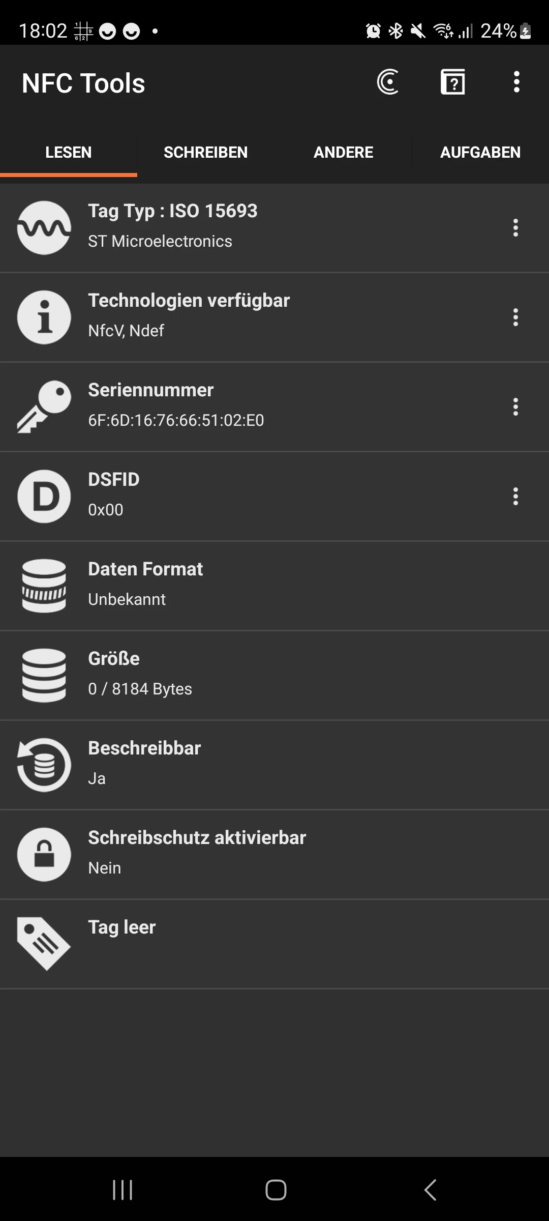

Hello everyone,
I am quite new to the STM family. I am currently working on a project where I need to send data to and read data from an NFC tag using an NFC reader (NFC07A1). This data should then be sent via Bluetooth to another microcontroller and output there via USART.

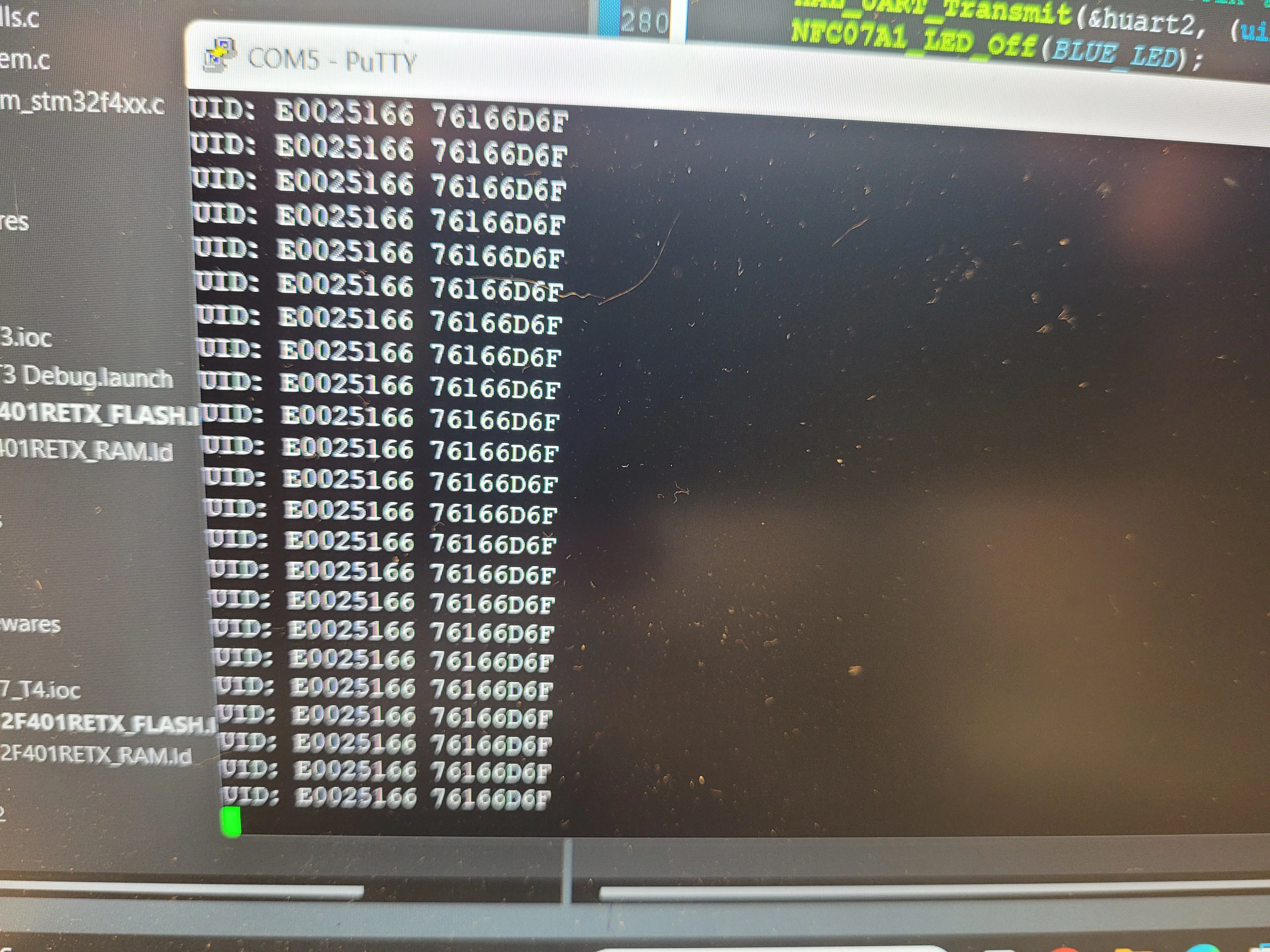

I have already familiarized myself with data input and output via USART. However, I first tried to read the UID of a tag. A UID is always displayed without using a tag. It turned out that it is the UID of the NFC07A1 because I read the UID of the reader using an Android app (just mirrored). As soon as I use my phone as a tag and hold it to the reader, an error message appears. Any other tag I have tried is not even recognized. Only the phone, but it is not readable.

    Best answer by Ulysses HERNIOSUS
    Hello Tamti,
    I think there is a misconception here: NFC07 is an NFC tag and not an NFC reader. It will not be able to read other tags.
    It is a so-called dynamic tag as it has also a wired interface to be able to exchange data with an NFC reader.
    BR, Ulysses
