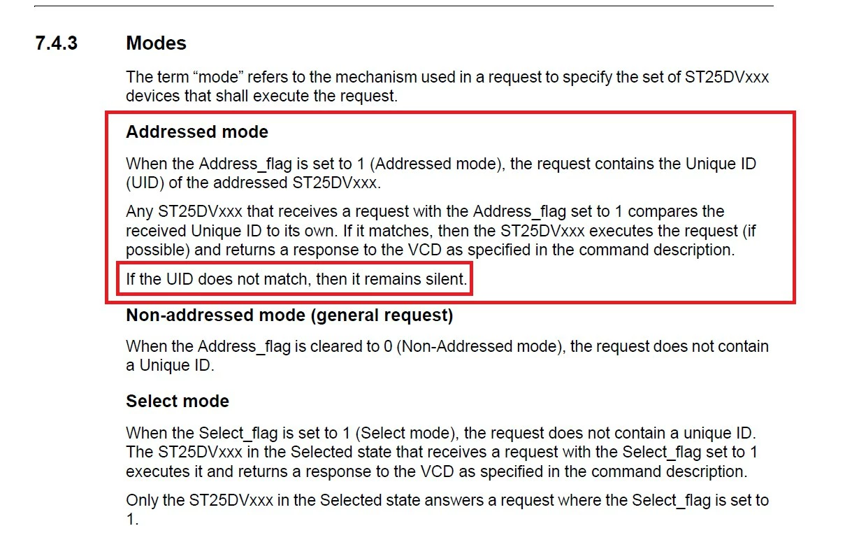

What can be the reason that ST25DV is not responding to addressed commands?
As documentation said, the tag didn't response if the message didn't contains the correct tag UID:
Maybe UID byte order (LSB/MSB) in Write Message is inverted and tag expects the other order?
Could it be a reader (smartphone) incompatibility in ISO-15963 for address mode transactions (I use the same reader device all the time)?
Sounds strange to me that no body report this problem before, maybe I miss something...

Hello
I will do some tests according to your issue with Android application and some updates/changes in order to reproduce.
Already did some tests with an external reader, not a phone, and found no issues……and have no tag answer only in the case of wrong UID set with or without @mode
If Tag do not answer, it is probably due to wrong UID…Your UID seems to be in the right order.
Concerning phone incompatibility, custom command in @mode on iOS is not working…..May be a track….! Which smartphone do you use ?
I will complete the answer as soon as tests done on Android side have been done.
BR

France Berthelot
June 10, 2020
​Hello
I have done some tests on my side with HUAWEI phone and works fine.
Do you have the same behavior with an other phone, Did you check with an other smartphone?
An other point, when host side is accessing the Mailbox, , the tag cannot read the UID present in memory so it cannot check if the command is for it or not. Perhaps this can explain "the no answer". For the moment, when using the Mailbox, it is wise to use non addressed commands
Do not have more information to provide for the moment .

JRios.1
JRios.1Author
June 21, 2020
Tested with other reader (Samsung Galaxy A40) and it works OK.
So I can verify that the issue is related to some Ulefone Power 6 NFC incompatibility when using addressed commands.
Issue solved, thanks.
