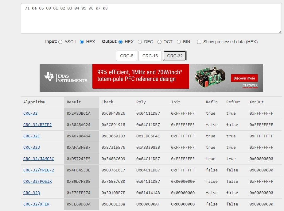

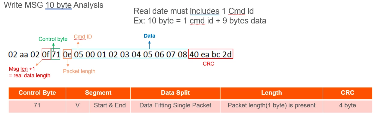

I used NFC Tap App to transmit data(use FTM write message cmd), transmit 10 byte
0693W00000Sv8L3QAJ.pngAs my analysis below the last 4 byte should be the CRC(4 byte),I think it's use CRC32 method, but I can't calculate the result as same as the App
0693W00000Sv8NEQAZ.pngResults by using on-line CRC calculator
0693W00000Sv8OMQAZ.pngCould you please verify this for me? thank you very much!

Hello Jerry,
I think you are mixing the Write message command (ISO15693 frame) with something else.
The Write Msg command format is:
02 aa 02 | 0f | 05 00 01 02 03 04 05 06 07 08
cmd code | msg len | data
Control Byte and Packet length and CRC32 you are inserting in the middle of the Write Msg command do not belong to this command.

jerry chang
October 3, 2022
Hi, Sorry for lately respond because I just ignore the CRC and proceed to develop my application.
The protocol I described is "FTM protocol" which you can refer to below url:
https://www.st.com/resource/en/user_manual/um2062-firmware-for-the-st25dvdiscovery-boards-stmicroelectronics.pdf
And I just wanna find which CRC32 method was adapted in ST FTM protocol
Thank you!
