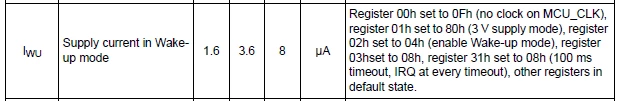

    I made the changes as described and disconnect pin 2 on CN6. I then programmed the wake-up Timer Control Register (31h) with a value of 0 in order to observe the wake-up current. When I measure the current through the 3V3 line, I got 5.5µA, but the datasheet says 3.6µA. How can I get closer to that value?
    Thanks.
    P.S. I am using the demo firmware from
    http://www.st.com/content/st_com/en/products/embedded-software/st25-nfc-rfid-software/x-cube-nfc5.html
    Travis Palmer
    March 22, 2018
    Posted on March 22, 2018 at 10:18
    Dear Joseph
    Can you please confirm that the oscilator and mcu_clk is not turned on?
    And the following conditions are fullfilled?
    Which kind of amp-meter have you used?
    The values for this mode would be 1.6µA min, 3.6µA typical and 8µA max.
