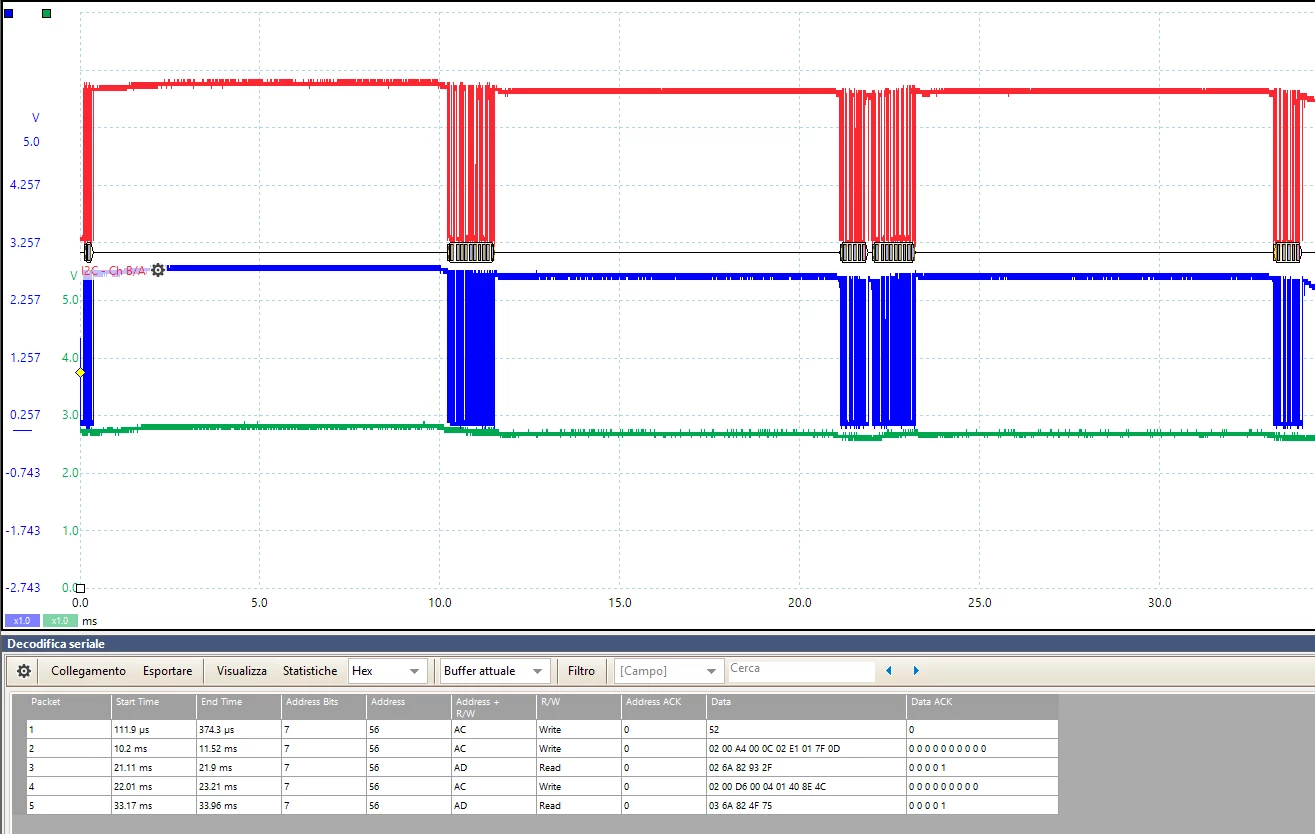

Hello, everyone,
I have a problem with setting the GPO of M24SR64-Y as an INTERRUPT. The micro needs to come out of Sleep condition through an Interrupt sent from smartphone via RF, I saw that you have to set the GPO with 0x4X, but I don't know how to send this packet to set the GPO as INTERRUPT.
The bytes I send and receive are:
SYSTEM Select and UpdateBin with the GPO Field at 0x4X (can be seen in the attached figure).
(BLUE-SCL / RED-SDA / GREEN-GPO)
I receive as a response (R-APDU) from the module bytes 6A 82.
Could you please help me out? Do I also need to implement the Capability Container to set GPO as INT?
Also, the packet I send as SendInterrupt is as follows:
0x56, 0x02, 0xA2, 0xD6, 0x00, 0x1E, 0x00 + CRC (0xCA,0x7F)
wanted to know if this is correct as a structure or if something is missing
Thank you very much

It seems from the command sequence that some steps might be missing for the M24SR to answer with no errors:
As per NFC Forum specifications, it is necessary for the NDEF Tag Application Select command to be sent (see chapter 5.6.3) before accessing the System File or any file
for that matter.
Also the tag might not be properly selected as after the ALL_REQ command, the SEL_REQ commands have to be sent, followed by a RATS. The NDEF Tag Application Select command comes after.
Hoping this helps
Best regards
