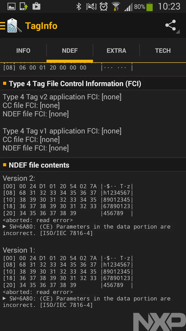

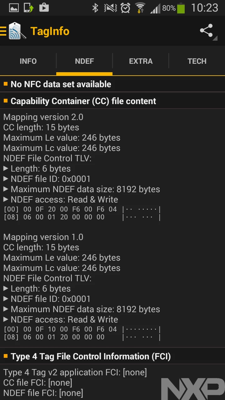

Dear Sirs:
We are using M24SR64.
Now we met a problem with NDEF File Length in 36 bytes.
Problem:
1. If the NDEF File Length is 36 bytes, it can not be a successful data in Android OS or NXP TagInfo app or NFC TagInfo app.
Only the app of ST ''M24SR Demo'' can show the payload we wrote.
2. If the NDEF File Length is 35 or 37 bytes, it is a successful Tag data.
At first, we used I2C to write the data and we met this strange behavior.
Then we used the M24SR Demo app to test it, it also fail in 36 bytes (35 or 37 are OK).
Here is a simple way to reproduce the stange behavior:
- Tested in Samsung S3 (Android 4.3, may PN544) and Nexus7 generation1 (Android 4.4.3, may 65N04)
- Use the app M24SR Demo (download from Google Play)
  -> Choose the NDEF editor and TEXT mode
  -> Key in the data (payload)
        1234567890
        1234567890
        12345678        (28 Bytes)
       or
        1234567890
        1234567890
        1234567890    (30 Bytes)
       => Above 2 are successful tag data (Record #1: TEXT record)
        1234567890
        1234567890
        123456789       (29 Bytes)
       => The Android will not response the data is a Tag data
       => NXP TagInfo or NFC TagInfo app show ''No NFC data set available''
       => Only M24SR Demo will show the payload we wrote.
  -> What I said 36 bytes is
      In NDEF file content
      00 24 (Total 36 bytes)
      D1 01 20 54 02 7A 68 (7 bytes)
      31 32 33 34 35 36 37 38 39 30
     (29 bytes as 12345678901234567890123456789)
We do not know the reason in this length.
At first we thought we had a bug in our I2C code.
Then we double checked by app M24SR Demo, it has the same stange behavior.
Does anybody meet the similar problem before?
Or please inform or correct where is the bug we have.
Thanks for your help!

wenkaiBest answer
Mar 5, 2015 3:24 AM UTC
Posted on March 05, 2015 at 04:24
Hi, Nicklas:
Sorry for reply lately.
(And I really appreciate for your discussion.)
Do you overcome the situation?
In I2C method, I ever meet M24SR did not ''ACK''.
0xAC + xx + .... + xx: OK
0xAD -> NACK
In the beginning of I2C communication, I mean step by step according AN4433,
I did not find this behavior.
While the data length gets longer, it happens
About this situation, i add a delay.
DELAY
0xAD -> ACK
The time of delay:
100us: Fail
200us: OK
500us: OK
1ms: OK
At last i use 200us in my FW.
Hope it is useful for you.
(p.s. I did not find any recommend from ST document about ''Delay''.
Thus, I did not sure if it is a correct way or not.)
(If you saw the recommend in any document, please tell me)
BTW, I did not really solve our problem as the subject.
We only can avoid to use the specific byte now.
We are not sure other bytes if OK or not.
Hope you and anybody can give us more information!
Thanks for your discussion.
Wen-Kai
