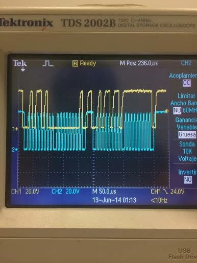

Hi I am using an Arduino UNO board to make an application to read the data of my M24SR64 antenna using I2C protocol. The problem is that I don't know if I am already communicating with it. I know from the datasheet that the address to read from a M24SR64 is 0xAD.

I also attach an image of the oscilloscope when I update the code above when the Arduino and the M24SR64 are connected and I asked from the address 0xAD 1 byte. You can see that 4 bytes are being read. The first one is a 0xB4 and it is generated when I begin the transmission with address 0xAD, the next one is the zero I write with the command Wire.Write(0), the next byte is a 0xB6 and it is generated with the command Wire.requestFrom(0xAD,1). And the last byte it is the byte that I am asking for in the command Wire.requestFrom(0xAD,1). If I may have asked for 2 bytes, then 2 0xFF would appear at the end of the oscilloscope. I don't know if I am already communicating with the M24SR64 antenna with those data.
I would be very thankful if you could help me. This is for a job I have to do this summer for the company I am working with.
I also do this with arduino.
I use#define M24SR_ADDR 0x56 /*!< M24SR address 7-bit*/
It works.

Posted on June 17, 2014 at 03:25
Yes, If the SRAM is not enough. UNO will crash.
I use 2560 to test.
You can find the I2C address with I2C_scanner.
The code here:http://playground.arduino.cc/Main/I2cScanner

Posted on June 20, 2014 at 03:12
Hi Eduardo,
Yes, use 0x56 is correct in Arduino.
You can refer to stsw-m24sr001 on
http://www.st.com/stonline/stappl/productcatalog/app?page=partNumberSearchPage&levelid=SS1812&parentid=1871&resourcetype=SW.
I also porting the code recently.
Ten

Hi aguilera.eduardo,
did you  finally find a solution? I'm in the same situation but still trying to communicate with an NFC/RFID card using Arduino UNO and M24SR64 antenna.
Using I2C scanner M24SR64 reply with 0x2D and 0x56 addresses.
could anyone help me? thanks
