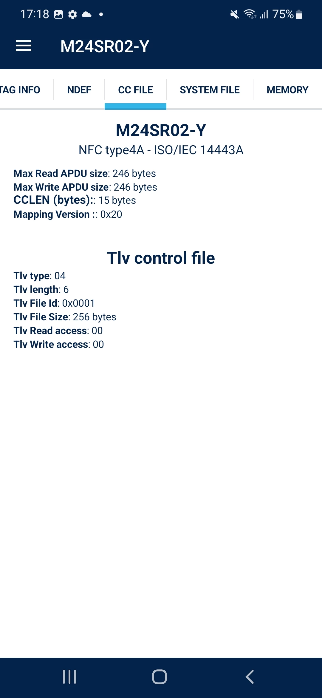

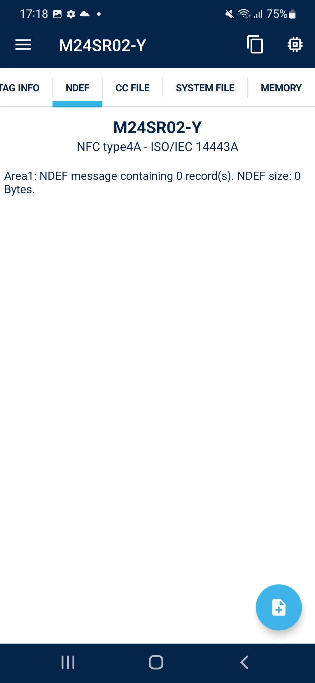

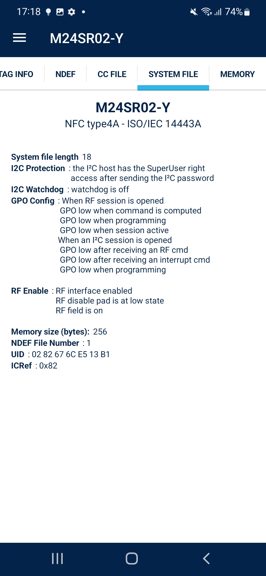

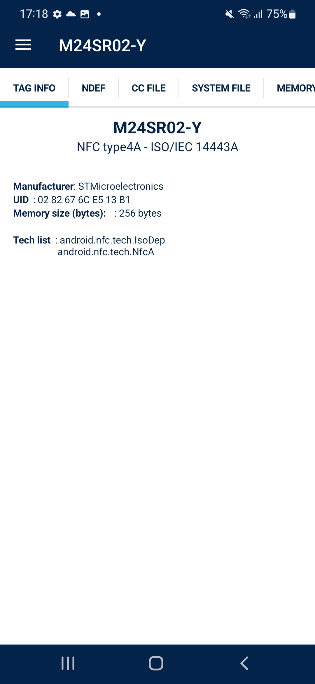

hhest.1
hhest.1Author
September 14, 2022
0693W00000SvNMpQAN.jpg0693W00000SvNN4QAN.jpg0693W00000SvNNOQA3.jpg0693W00000SvNNTQA3.jpgThis are the informations the app gets from the tag. To close the I2C session I just turn off the supply voltage of the tag.
The NDEF file seems to be empty, but during communication via I2C I get "command completed as response. Here is the whole writing process:
