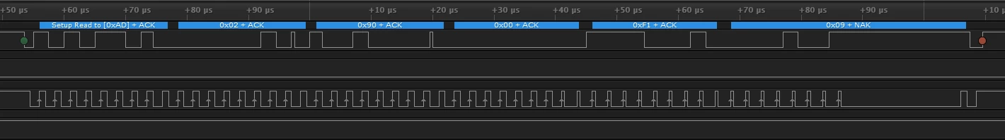

Hello Everyone,
            I've got some strange behavior on the M24SR tag that I'm using. The last byte of an I2C data transfer either to or from the chip is being NAK'ed and looks to be throwing off the HAL drivers in the STM32 that I'm useing to talk to it. Is this expected behaviour or is it behaving oddly and if it is oddly then does anyone have any ideas. An example of what I'm seeing is attached.
Thanks
Luke

    It's the master who acknowledges read... so if STM32 is the master, it's STM32 (and the software it is running) which performs the NAK at the end.
