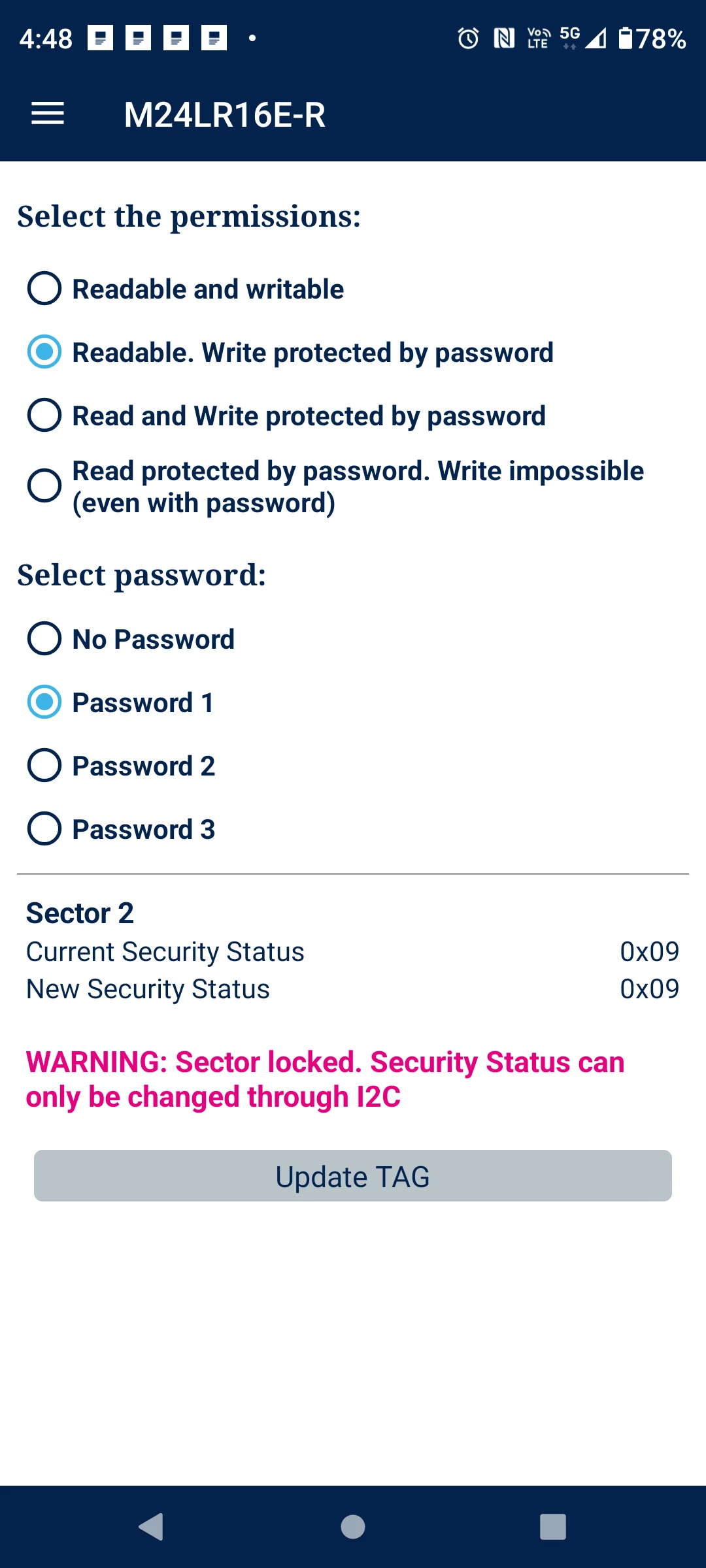

When I read data from the problematic EEPROMs through St25 mobile application, I observe the following:

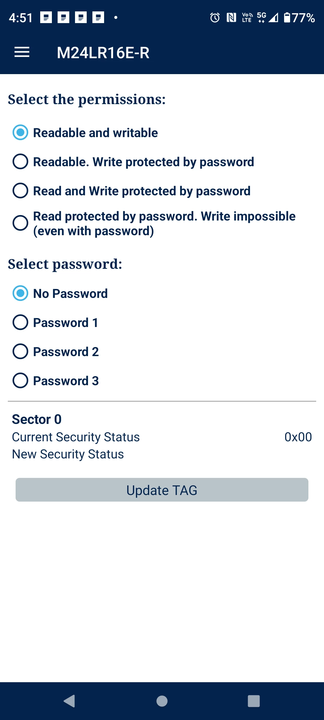

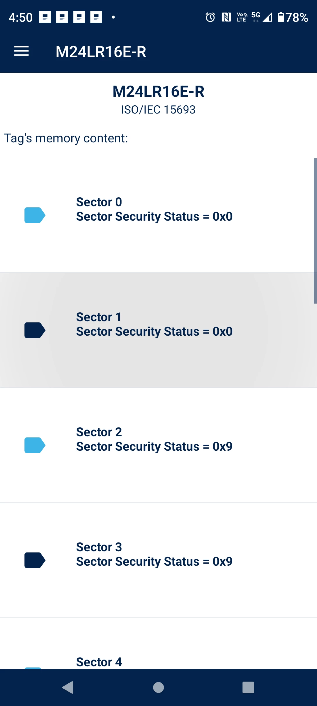

  • Sector 0 and Sector 1 Security Status is 0x00. And the data read and write is working in these 2 sectors.
  • Sector 2 to Sector 15 Security status:
    • Current Security Status: 0x09
    • New Security Status: 0x09
Additionally, I receive the warning:
“Sector locked. Security Status can only be changed through I2C.”
I am not sure why the security status has changed or why the sectors are locked.

It is possible to unlock a sector, but only from the I2C interface. Once locked, a sector cannot be unlocked from the RF interface,
To unlock the sector, the I2C password must first be presented, then it is possible to write in the system area from I2C to unlock the sector.
There is no clue in what you describe that can explain why those sectors become locked. Most probably a lock-sector RF command has been issued at some point, or the sector security status byte has been programmed from I2C at some point. If you describe more your setup and what you are doing with the tag it may help understanding.
Best regards.

To access the SSS configuration from I2C you can:
Read the SSS from I2C:
  • the device select code must be with E2=1: 0xAE/AF
  • the memory address of the SSS starts at 0x0000 (SSS0 sector 0), 0x0001 (SSS1 sector 1), 0x0002 (SSS2 sector 2) and 0x0003 (SSS3 sector 3), etc…
  • Example to read the SSS3 of sector 3: Start/0xAE/0x00/0x03/Restart/0xAF/SSS3/Stop
If bit 0 (Sector lock) is set, it means that the sector is protected. The bits 2 and 1 determine the type R/W of protection and the bits 4 and 3 determine the password used to protect.

Based on your guidance, I was able to understand the SSS configuration and successfully unlock the sectors using I²C commands. After unlocking, I am also able to read and write the memory using the ST25 mobile application via NFC without any issues.

Actually, the sectors can be locked in two ways:
  • from RF: using the Lock-sector command (code B2)
  • from I2C: you must first present the I2C password, then writing in the system memory (device select code 0xAE) at the address of the SSS.
Those are the two ways of locking sectors. there is no effect or side effect of simultaneous or alternate I2C /RfF commands.
I guess that during your process, a Lock-sector command is sometime issued, or the I2C is writing the SSS, difficult to say.
If you have a trace of all RF command sent by your application, you can search for an RF command with command code 0xB2.
As for your last question, I assume that you are able to write in EEPROMs with SSS=0x09 because somehow the correct Present sector password command has been issued at some point (command code 0xB3). Once the correct password has been presented (here with SSS-0x09 it should be password 0x01), the security session is opened and the write is possible.
Best regards.
