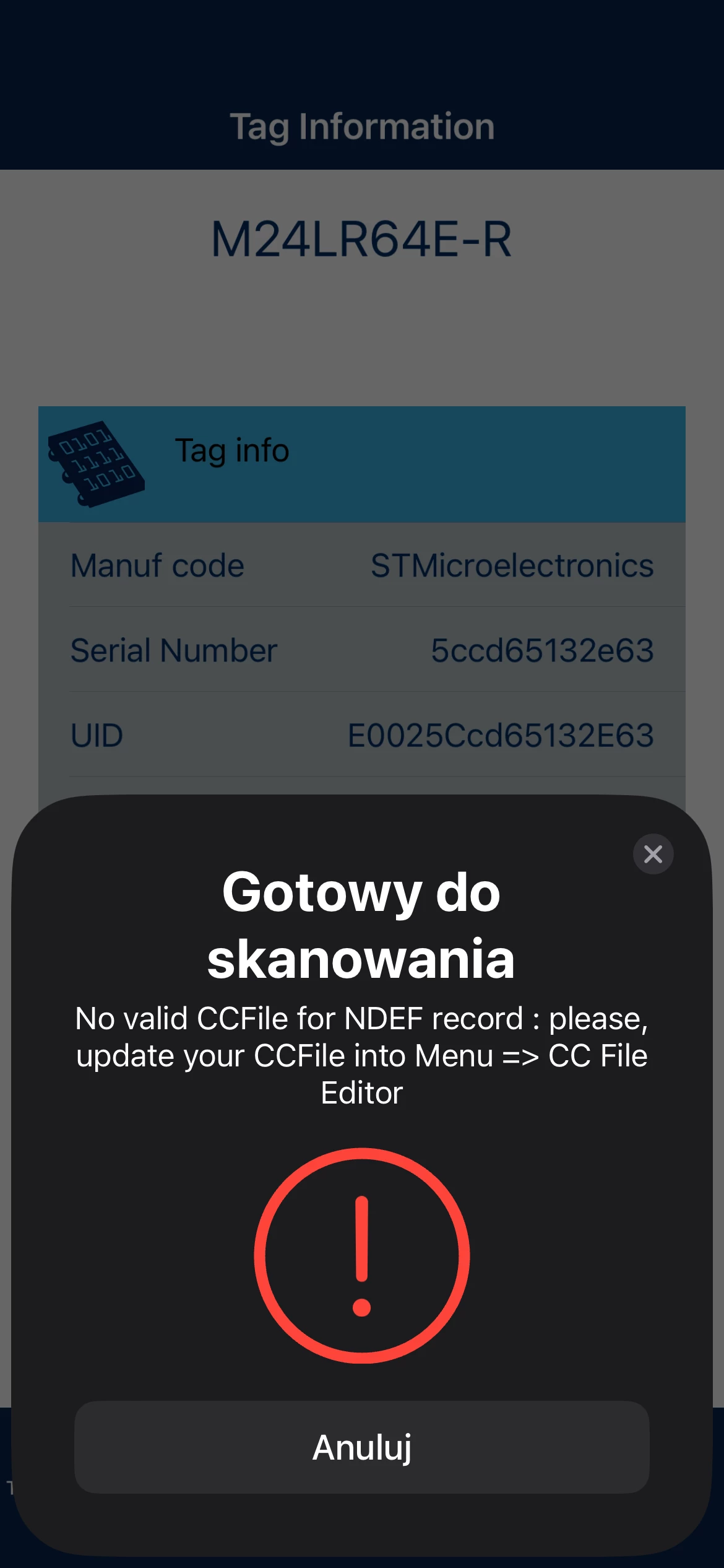

Hello, I build a business card with the M24LR64E-RMN tag.
When using NFC Tap application on Android everything works perfectly. I'm able to write and read the NFC tag.
However, when using with iPhone 12 (IOS 17.7.1) - while reading a tag I'm getting the following fault. I'm not able to write NDEF commands and neither can I read the tag (When with Android everything works fine).
Have any of you face similar issues?
Best answer by victor laraison
Hi Mkoza,
All my apologizes, but M24LR64 is not supported by iOS CoreNFC.
I invite you to have a look on thread https://community.st.com/t5/st25-nfc-rfid-tags-and-readers/nfc-memory-m24lr-64-er/td-p/647758
hope it clarifies.

Hi Mkoza,
hope it clarifies.
