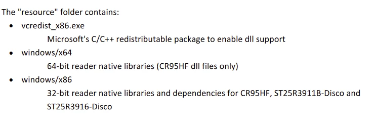

I'm trying to use the ST25 java SDK. The software_guide pdf document says I need to load in my IDE the natives libraries the SDK will need. It says I will find them in t \readers\st\resources, but in this folders there is only windows/x86 for the DLLs, and no windows/x64 as is mentionned in the document. And I can't use the 32bits version in my 64bits JVM. Am I missing something, or did the x64 folder was forgotten in the release ?
Extract from the pdf guide :
_legacyfs_online_stmicro_images_0693W00000bjndLQAQ.pngthe readers/st/resources/windows folder from the sdk :
    Best answer by NFC/RFID Customer support
    PC software for 64-bit windows platform is planned for end of year (PC software and streader dlls). Anyway we plan to start to update streader DLL for 64-bit in fews weeks. I suppose I will be able to share with you "draft" versions of streader dlls for 64-bit in few weeks.
    I think the best solution for your project, should be to work to put in place environment including SDK using 64-bit FEIG DLL. Then we will be able to share dlls for streader (draft version).
    NFC Customer support
    18 replies
    May 10, 2023
    Thank you for reporting this error. There should indeed be a windows/x64 folder in the release package.
    Note that amongst the ST reference readers, only the CR95HF board is supported in 64-bit configuration as of today. For other readers, such as ST25R3911B/16, etc., you will need a 32-bit JVM.
    Please find attached the 64-bit dll files for Windows and the CR95HF board.
    This folder will be added in ST25SDK release 1.10.3.
    Best regards,
    Damien

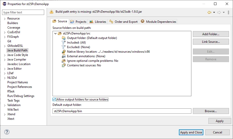

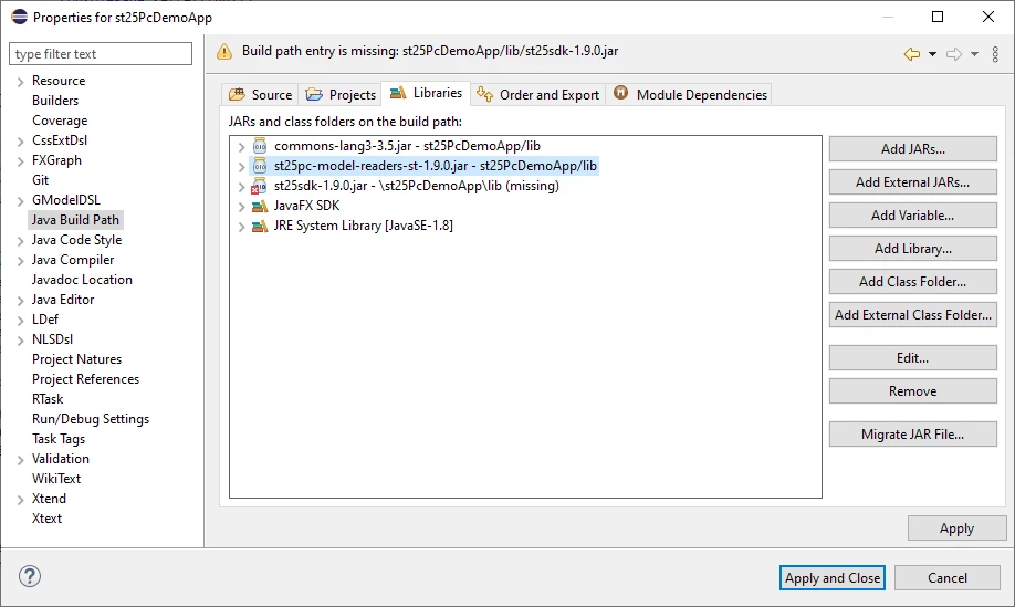

    Make sure you indicate the path to the reader library in your application's Java Build Path as shown below:
    As a reminder, the dll path should be indicated in the Source tab of the Java Build Path

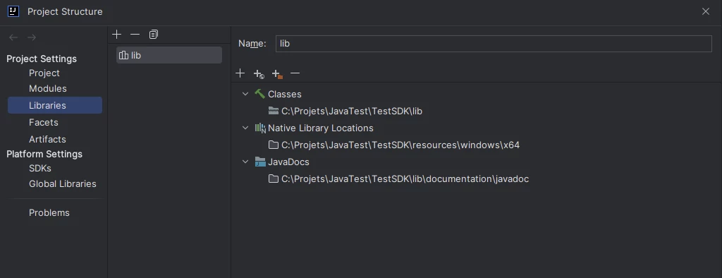

    I am using Intellij Idea, and not Eclipse, but I believe I set up both the dll folder and the jar folder right, but I still got that same error.
    _legacyfs_online_stmicro_images_0693W00000bjqwBQAQ.pngThe lib folder contains :
    _legacyfs_online_stmicro_images_0693W00000bjr6KQAQ.pngAnd the resources\windows\x64 contains the folder you sent earlier

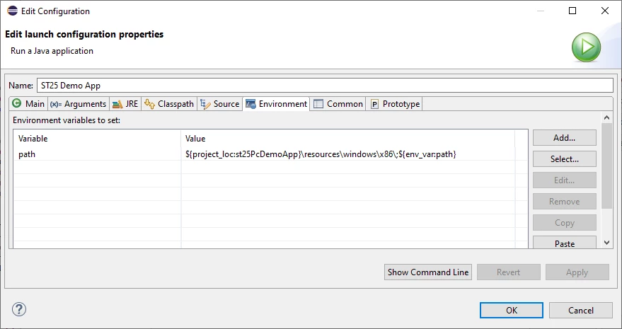

    So I come back here with yet another problem.
    I managed to find and install a 32bit JDK (not that easy I'll add, because Oracle website doesn't propose a 32bits version of the last version. Working on 32bits will add a lot of trouble to my project, since I planned on using Jpype to create a Python wrapper of your SDK, and I will have to use a 32bits Python to do that.
    But for now, I am just testing things out on a test Java project, and I still can't get it to work. I still get an "UnsatisfiedLinkError" :
    Exception in thread "main" java.lang.UnsatisfiedLinkError: C:\Projets\JavaTest32bits\sdk32bits\resources\windows\x86\streader.dll: Can't find dependent libraries

    May 12, 2023
    in Eclipse we need to append the path to the resource folder to the path environment variable, such as shown in the picture below:
    _legacyfs_online_stmicro_images_0693W00000bjwwuQAA.pngMake sure your path is updated in your run environment as well.
