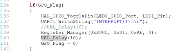

I'm working with the NUCLEO-NFC07A1 (that mounts ST25DV64KC chip), and I'm trying to read the dynamic registers via the I2C interface. However i've some problems reading the IT_STS_Dyn register at 0x2005 addr.
This register should indicates which event triggered the GPO interrupt.
I've configured the GPO1 register to trigger interrupt for various source. When an event occurs and GPO1 interrupt is activated, I expect to see some bits in the IT_STS_Dyn register set to 1, indicating the source of the interrupt. However, when I read the IT_STS_Dyn register via I2C, I always get a value of 0x00.
In addition, I've noticed that I encounter the same problem (getting a value of 0x00) when reading all the dynamic RO registers. In contrast, the other dynamic registers that are not RO don't exhibit this behavior and return expected values.
I'm wondering if there are any additional configuration steps required, or if I'm making an error in the reading sequence. Has anyone experienced similar issues or have suggestions on how to resolve this?
Thank you in advance!

There is no specific configuration to read dynamic registers, whether they are RO or not.
Nevertheless, the IT_STS_Dyn register is special compared to other dynamic register because it is reset to 0x00 when it is read.
This means that if you read it twice quickly (quickly meaning before a new interruption occurs), the first read will give you the interruption status with correct bits set to 1, and the second read will give you all 0.
Another reason to have all 0 in the IT_STS_dyn register may simply be that the interruption has not been triggered. Are you sure that the interrupt has occurred ? Where you able to capture it on the GPO output?

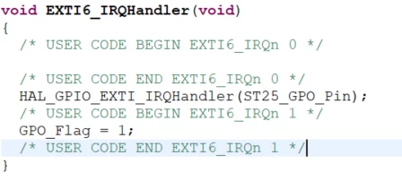

Let me explain in more detail what I’ve done. Essentially, I’m controlling the NFC07A1 board using a Nucleo-U575ZI-Q. I mapped (through  STM32CubeIDE) the GPO pin to the corresponding micro's pin as GPIO_EXTI6 (PA6). At this point, I’ve activated a flag when the interrupt occurs, and in the main, I handle the function related to the flag with very simple code as you can see in the following figures:
Then, I performed various tests by setting the GPO1 register to different values to verify that the interrupt is triggered correctly. For example, I tested the EEPROM writing (RF_WRITE_EN pin) using the Android app made by ST, and then I tested for the presence of the field (FIELD_CHANGE_EN).
As you can see, I’ve enabled the function Register_Manager(0x2005, 0x02, 0xA6, 0), which is a simple function I created that allows me to read the 0x2005 register via the I2C protocol (I'm sure that this function works because I used it to read and write many registers before). However, every time an interrupt is triggered, this function always returns 0x00.

JL. Lebon
September 4, 2024
Can you try to read the EH_CRTL_Dyn regsiter (0x2002), just to check that the register read is performed correctly?
If you have only VCC as power supply and energy harvesting disabled, you should read 0x04. If there is also RF field present + VCC, you should read 0x06.
Best regards.
StefanoSperandio_STAuthorBest answer
September 10, 2024
Hello!
Thank you for your precious support...i've resolved the issue modifying the order of the i2c functions and somethings in the custom function (Register_Manager function).
Now i can read all the Dynamic RO register...
