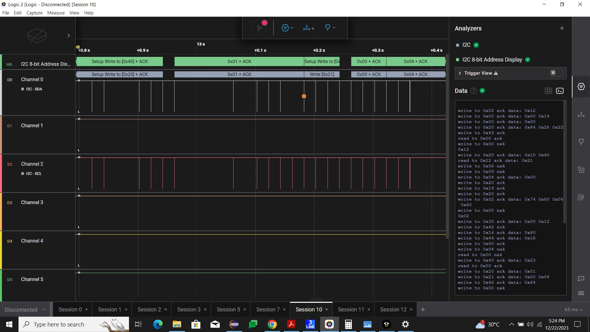

So basically I am connecting ST25DV64KC tag with MKE14F512VLL16 based controller and I want to write on the tag through i2c but as I am sending data using I2c write and as I am checking using Logic analyzer it showing its writing and sending ack but when I am checking using st nfc tap app  options read memory  there nothing was written can you guys confirm few things like is tag slave  device address  is 0xA6  for writing on tag and is it mandatory to give memory address or it will assume 0000h as base address and write on it  and to write on tag do we need to send one byte at a time .Can you please provide details about i2c communication to  write on tag by the way I have already gone through the datasheet.

So in logic analyzer I am getting ack from device and also its showing writing random data in some random address but if we try to read memory using the st nfc app nothing is there  .So i am sharing some logic analyzers pic with you guys if you can suggest about what can be the problem it will be helpful--
JL. Lebon
December 22, 2023
Sorry, but the logic analyzer traces don't help as we can't see the I2C frame at bits or even Byte level: "write to 0x02 ack data:0x12". What does it mean ? Do you write to I2C slave address 0x02? This is not ST25DV64K address...

You were mentioning in you first post that you received an ACK at each write, but in you screenshot it seems to be an error response (not easy to read the answer). Does this response error is due to Debugger stop or sent when in run mode too.
If you could capture with the logic analyzer a single write sequence and zoom in to see the SDA/SCL bits to see in more detail what is happening.
