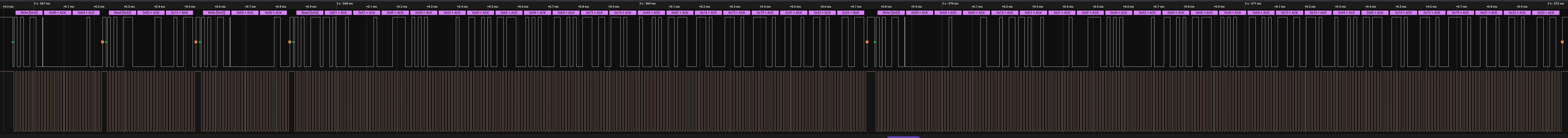

I have an I2C logic analyser. Here's an example of successful read/write using I2C only. I make an NDEF text entry with the string "TestEntry123". Too be clear these transactions work as expected.
write to 0x53 ack data: 0x00 0x04
read to 0x53 ack data: 0x03 0x13
write to 0x53 ack data: 0x00 0x06
read to 0x53 ack data: 0xD1 0x01 0x0F 0x54 0x02 0x65 0x6E 0x54 0x65 0x73 0x74 0x45 0x6E 0x74 0x72 0x79 0x31 0x32 0x33
write to 0x53 ack data: 0x00 0x04 0x03 0x13 0xD1 0x01 0x0F 0x54 0x02 0x65 0x6E 0x54 0x65 0x73 0x74 0x45 0x6E 0x74 0x72 0x79 0x31 0x32 0x33
The last line with the read does give me an NDEF message of "TestEntry123" as intended.
Here is the actual I2C signals... again this is the working signals. running at 100kHz.
0693W00000NqDG8QAN.pngWhen read from NFC Tools, 1 record is found. UTF-8 (en) : text/plain "TestEntry123"...as expected. Great that works.

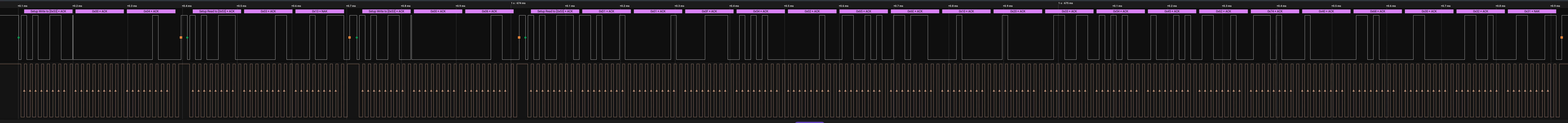

Now here is where my problems begin; I will use NFC Tools to write a DIFFERENT NDEF text entry, and my firmware will just read from the tag via I2C instead of writing anything. I will provide the transactions below. When I read the tag again via NFC Tools, i get the correct text entry data in the app, and when I read the raw memory from NFC Tools, everything looks good and as expected. If I write the same NDEF text message as I written with I2C previously, there is no issue.
In these transactions after I wrote "123TestEntry" via NFC Tools, I simply just read the data from the tag. Again if I just wrote "TestEntry123" (the same as what I wrote via I2C previously), I will be able to read using the same I2C requests below without issue.
read to 0x53 ack data: 0xD1 0x01 0x0F 0x54 0x02 0x65 0x6E 0x10 0x20 0x33 0x54 0x45 0x62 0x74 0x40 0x68 0x30 0x32 0x31
This gives me text output: "0x10 , 0x20 ,  3 , T ,  E ,  b ,  t , 0x40 ,  h ,  0 ,  2 ,  1"
This output is repeatable.
Here is the I2C signal.

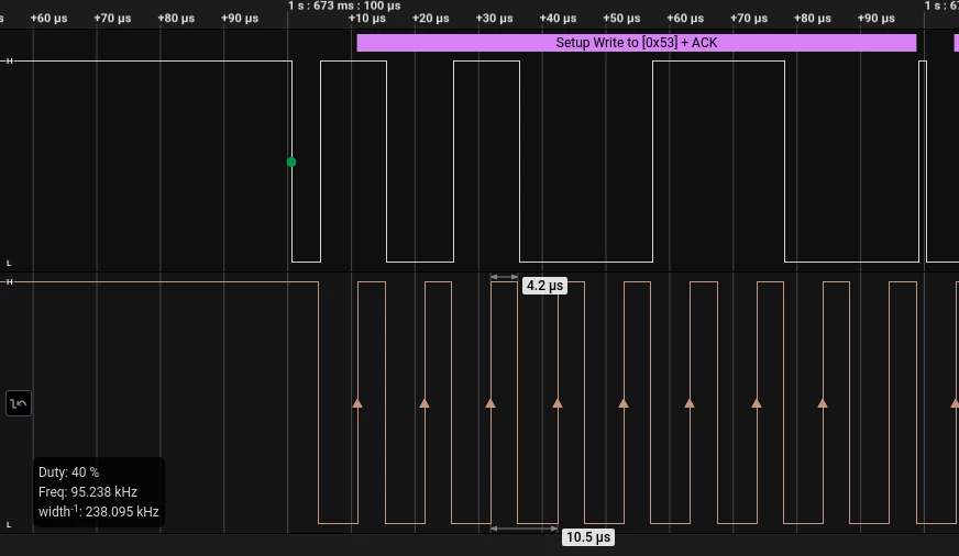

0693W00000NqDM6QAN.pngCloser look at the clock.

Ulysses HERNIOSUS
May 20, 2022
Hi KKosi,
I quickly did an analysis of the expected pattern vs the received pattern on I2C:
1 2 3 T e s t E n t r y
0x31 0x32 0x33 0x54 0x65 0x73 0x74 0x45 0x6e 0x74 0x72 0x79
If you inspect the hex digits you can see that line 3 compared to line 2 shows only bits going from 1->0 and never from 0->1.
Possible explanation for this could be two I2C devices driving data. I2C with its pull-ups and devices only driving zeroes allows exactly such behavior.
When inspecting as suggested by JL. Lebon using a scope you could possibly see this: Some 0 would be stronger / lower than others when both devices are driving a 0. But you need to watch out for such.
Best Regards Ulysses

Ulysses HERNIOSUS
May 19, 2022
Hi KKosi,
I do have a wild idea that the issue could still be on I2C. I have seen in the past cases where I2C devices incorrectly "felt" addressed by data going/coming from other devices and started garbling data on the I2C bus.
So I would also make a trial to disconnect the other devices from the I2C bus and see if the issue persists.
Best Regards, Ulysses

KKosi
KKosiAuthor
May 20, 2022
I have found that my EEPROM M2402 was interfering. I pried it off my PCB and now I can read from the NFC device properly.
Thank you.
