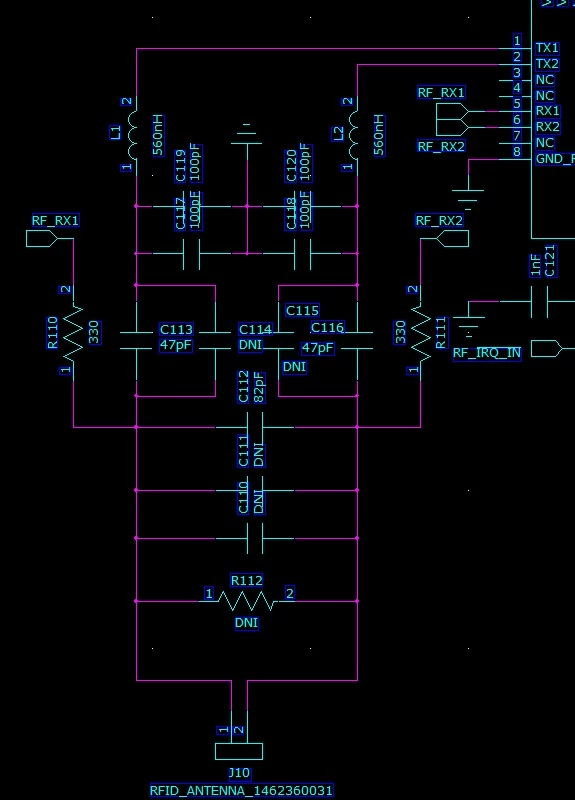

Is there are possible to let the ST25R95 reading distance be over 30cm?
  • November 1, 2021
  • 5 replies
  • 2936 views
I am doing a project which requires ST25R95 reading distance operating about 30cm. I studied the EV kit of ST25R95 and implemented the circuit as a reference to design my system.Unfortuneately, the reading distance is still around 7cm. After several days of studying the AN5248 and tuning the STSW-ST25R003, I still can not get a breakthrough in a longer reading distance and better magnetic field performance. Is there any reference circuit design that I can study to enhance my design?
PS. VPS_TX is connected to 5V, it suppose output power at 230mW
reader antenna: Molex 1462360031
tag model: ST25TV-ESEAL

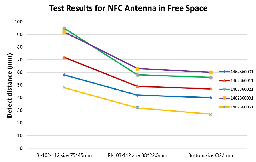

    Thank you for answering my question. The link you provided did little help in finding a suitable antenna in my design. From the test report on (page 11)https://www.molex.com/pdm_docs/as/1462360001-AS.pdf
    1462360031 could receive signal over 30cm. The NFC IC TRF7970 they use could merely output 200mV per reading cycle( ST25R95 could provide 230mV!!) Therefore, I thought ST25R95 could get a higher distance in my design but it seems I am still stuck in solving this problem.

    I read figure 6.1.4 as reaching ~90mm (=9cm) distance with a 75*45mm tag. Interpolating the diagram between 75*44 and 38*22.5 tag antenna I would expect an operating range in the 7 to 8cm area.
    Not sure where you are reading 30cm???
    0693W00000GWKr8QAH.pngAt such small antenna I also don't expect a major performance boost by further increasing the output power, especially not when going from max 200mW to max 230mW.
