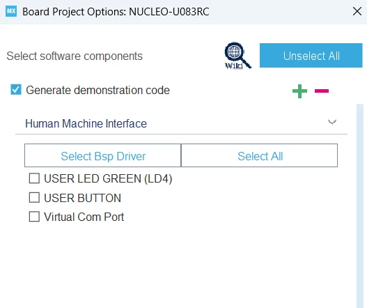

Mihaita Ivascu
May 20, 2025 3:50 PM UTC
Yes I was able to generate it already. This is really helpful feature. thanks.
But although I select application it does not generate code for application(ndef demo for example). but it does so for BSP, drivers and all level.
Thanks,
    Mihai
Brian TIDAL
May 20, 2025 10:07 PM UTC
make sure to properly configure the components:
and then:
This should generate the NDEF application.
Rgds
BT

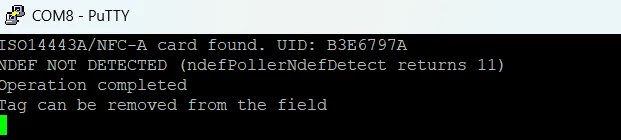

May 27, 2025 3:18 PM UTC
Hello BT,
    Thanks a lot for the *.ioc . It works without issues. So I must have been done something wrong when configuring the ioc on myself on CubeMX.
    I run the example and get on console:
Not sure if it's expected.
Thanks,
     Mihai
Brian TIDAL
May 27, 2025 8:50 PM UTC
Well done!
The tag being used seems to be not NDEF formatted (either not supporting NDEF or requiring some proprietary steps to enable NDEF support). I would suggest to use NDEF ready tags such as ST25TA (T4T), ST25TN (T2T) or ST25TV (T5T). See ST25-TAG-BAG-UT1 or ST25-TAG-BAG-UI1 for samples.
Rgds
BT
