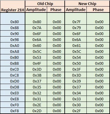

SD.5
SD.5Author
May 11, 2021
Hi Ulysses,
On the reference code, There is a comment says that the Antenna calibrate command needs to be run twice( Errata #1.5). (Screenshot attached)
Can you share the errata 1.5 with us?
Please find the Amplitude and Phase values for both the chips.
Thanks
Sarav
Ulysses HERNIOSUS
May 11, 2021
Hi Sarav,
can you double check your phase measurements it is always 0x00 (>=150deg)? Which function did you use? From RFAL?
With such a phase for all trim values the Calibrate Antenna should always have produced an error (also in the old ST25R3911) as the target phase could not be achieved.
I will need to discuss internally, it would be helpful if you could use VNA to produce smith charts of at least trim values 0, 7 and 15 and share them here or with me.
Regards, Ulysses
XP.1
May 12, 2021
Hi Ulysses,
for measuring Phase we have used the Measure-Phase-Direct Command 0xD9 and read out the A/D output register 20H
Regards
Xavier
Ulysses HERNIOSUS
May 12, 2021
Hi Xavier,
this procedure sounds right, I assume you delay sufficiently/wait for the termination interrupt in between?!
Any chance that you can do smith charts as in AN4914 for some trim values?
The AN4914 presents also that the similar algorithms can easily be implemented in SW (measuring 16 points and picking the best - I recommend the one with highest amplitude). Could this be an acceptable change which solves the issue for you?
I am suspecting a minor change of behavior of the internal algorithm (between ST25R3911 and ST25R3911B) when the target phase is not reachable, but would need to do more investigation here.
Regards, Ulysses
