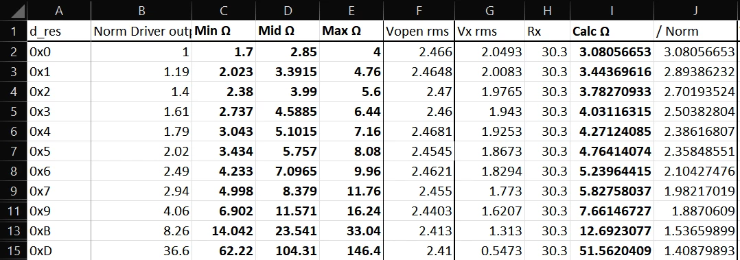

I am designing an NFC transmitter that uses ST25R3916B-AQWT.
​The coil will be connected to the RFO1/2 pins.
In order to design the coil properly, I will need to know the driver's impedance spec for the various d_res<3:0> multiplier values (Table 78 of the ST25R3916B Datasheet).

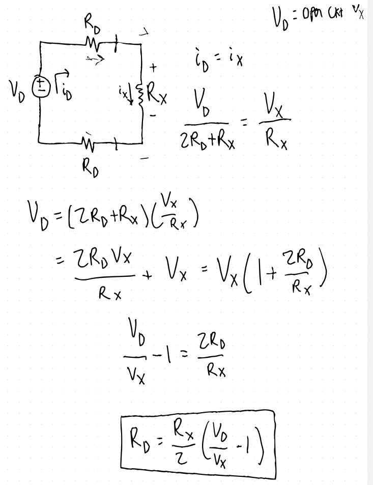

I was able to find the resistance values and also measure them using a resistor as the load to calculate the driver output impedance (sum of both RFO1/2). It approximately correlated to Table 126 and Table 78. Results and calculation used attached below. I used an oscilloscope to measure the load voltage.
What I am unable to measure with this method, and need to know, is the imaginary part of these measurements. In other words, what the capacitive and inductive loads are as well for at least the RFO1 and RFO2 drive output value (i.e. Table 126).
Please let me know if you have these specs or an idea of how to measure. Thanks so much for your help.

Hi sshafer,
During production we ensure/test that several parameters are within specification and guarantee device operation as specified in the datasheet.
Unfortunately the imaginary part of the driver impedance is not part of those production tests.
You could try to measure the impedance via a DC-block connected to the VNA (Without turning on the driver => tx_en = 0).
When the device is outputting VDD_DR level on one RFO and GND_DR level on the other RFO when not beeing active. This is why you need a DC Block.
BR Travis
