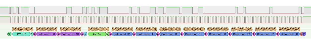

Hi. I'm getting weird data when reading UID from ST25DV04K via i2c.

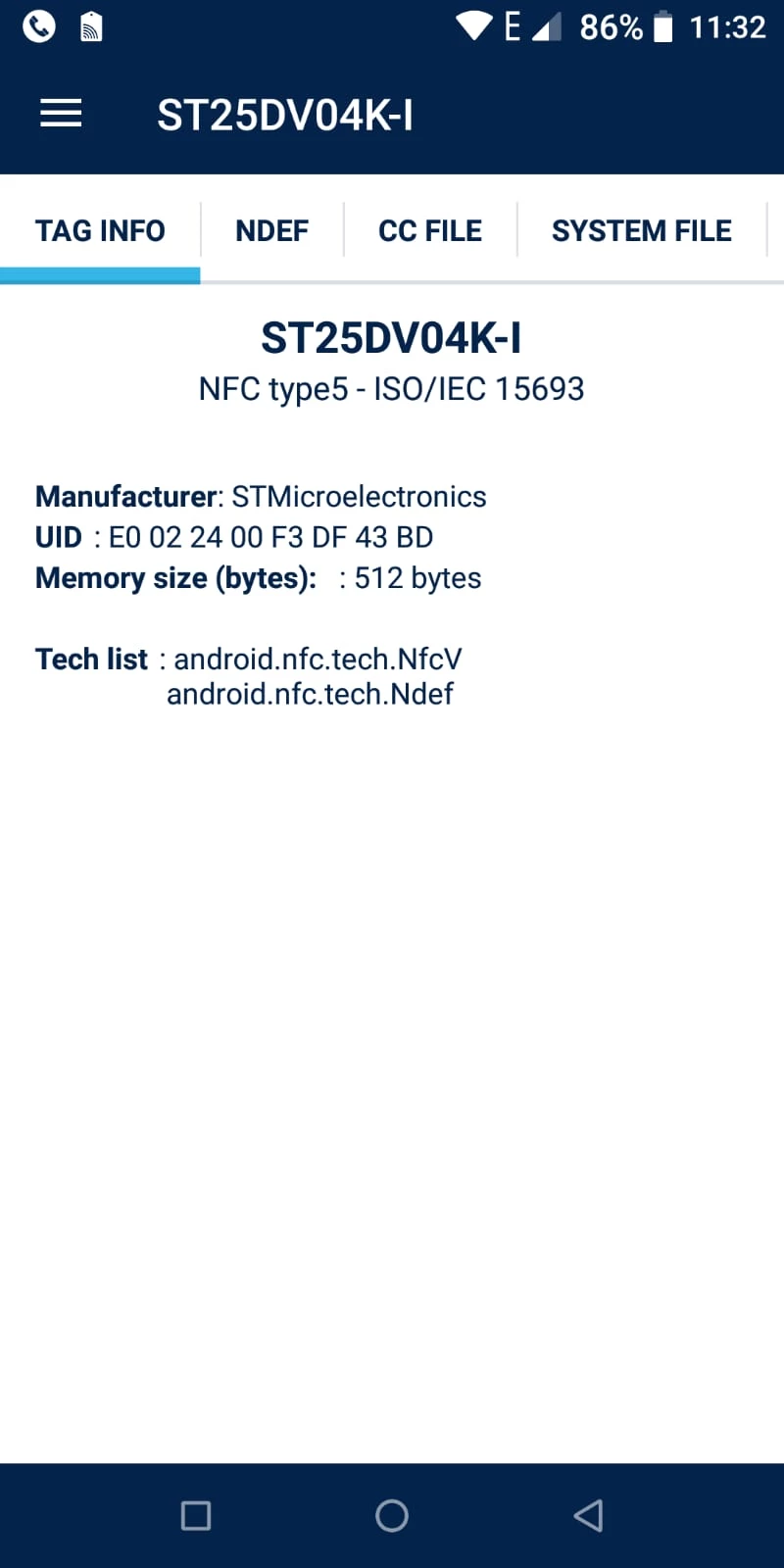

Tag id should be 0E 02 24 00 F3 DF 43 BD
When reading via i2c
HAL_I2C_Mem_Read( nfcI2c, ST25DV_Address_E21_read, UID_ADDRESS, 2, nfcUID, 8, 0xFFFFFF );
i'm getting 00 02 24 00 F3 DF 43 01 ( first and last byte are wrong )
When reading via i2c byte by byte
for( int k = 0; k < 8; k++ )
			HAL_I2C_Mem_Read( nfcI2c, ST25DV_Address_E21_read, UID_ADDRESS + k, 2, nfcUID + k, 1, 0xFFFFFF );
00 00 00 00 01 01 01 01
Tried 100k and 400k speeds.
Logic analyzer shows the same
Android app reads UID via RF correctly
Best answer by ABank
Found the problem - got 24AA02UID on the same i2c line - it takes multiple i2c addresses as it's own and conflicts with ST25DV04K
