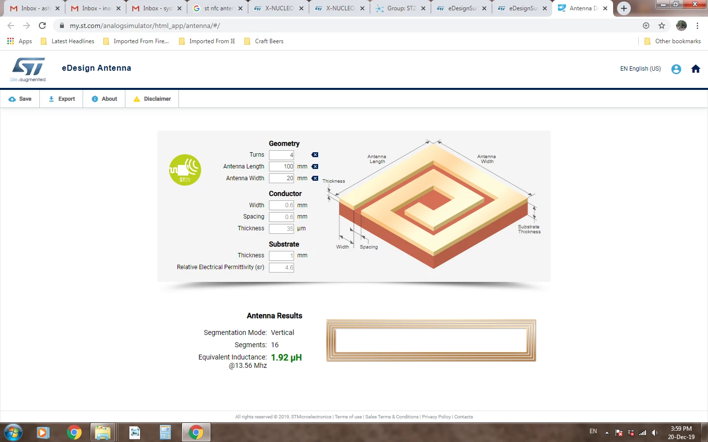

I wanted to know the X-NUCLEO-NFC01A1 Boards Antenna Details
I have X-NUCLEO-NFC01A1 Board with M24SR chip. I am Currently Developing a Product using it. For my application i want the antenna to be in Flexible PCB with 100mmx20mm outer dimension.
For this I am using eDesignSuite NFC Antenna Design tool. 0690X00000BurEHQAZ.pngi wanted to know how to calculate the antenna matching circuit for this antenna.
also i wanted to know the inductance and and antenna parameters of the antenna present on the X-NUCLEO-NFC01A1 Board.

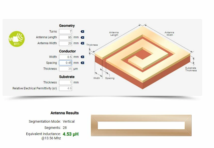

    A double layer antenna as well as using trimming caps between AC0 (respect. AC1) ang GND are not necessary. for your specific need, you can design a signle layer coil 100x20mm with 4.7µH max inductance.
    You could target 4.5µH for instance and adjust tuning frequency with parallel tuning cap as C2. Based on Edesign Suite, it could be:

    Henry Crane
    Jan 14, 2020 4:02 PM UTC
    Edesign suite example a
