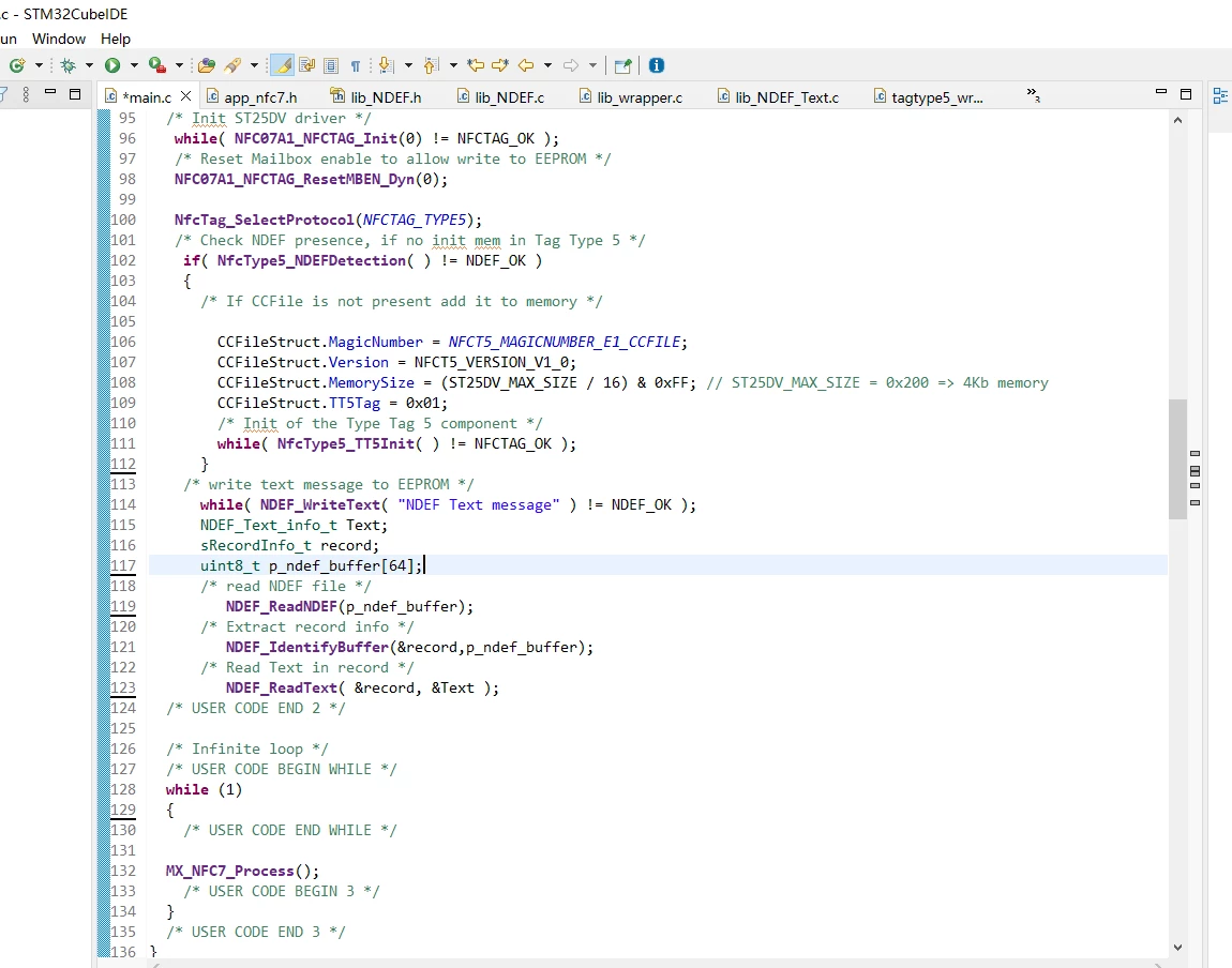

    Schuyler
    SchuylerAuthor
    March 22, 2023
    I took your advice and wrote a text message, but the phone ST25 Tap APP does not show any NDEF information, what should I do?0693W00000aJKfzQAG.png
