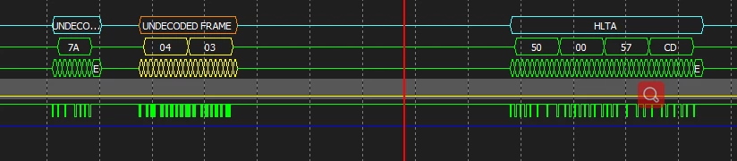

I want to emulation the non-standard NFC protocol (not T3T, not T4T). only use The AFE of ST25R3916 to send and receive data;
just like this:
0693W000006FPqLQAW.pngIs there an example like this this I can refer to

Can you elaborate on the non-standard protocol? is the anti collision also non standard or is the anti-collision compliant with ISO14443-A ?
I mean, is the non-standard protocol only used after the card enters ACTIVE state?
Can you confirm also that only ISO14443-A modulation is used?

嗨布赖�?� · 蒂波 (圣员工)
在命令的开头和传输中,有一些�?�标准�??议;
大多数�?然是标准ISO14443-A,包括防撞;
我肯定是 Iso14443 - A 调制

Hi @zjhon.1 (Community Member)​
the NFC Forum Activity specifications defines Card Emulation for TA4, T4B and T3 types. Our rfal_nfc convenience layer implement the card emulation for those types as defined by the NFC Forum.
If I well understand you need, you would like to emulate something close to T2 with additional proprietary commands. In my understand is correction, I would suggest to follow the recommendation provided by Ulysses HERNIOSUS to hack the T4T Card Emulation case in rfal_nfc.
Feel free to provide more information about your application and your use cases.
