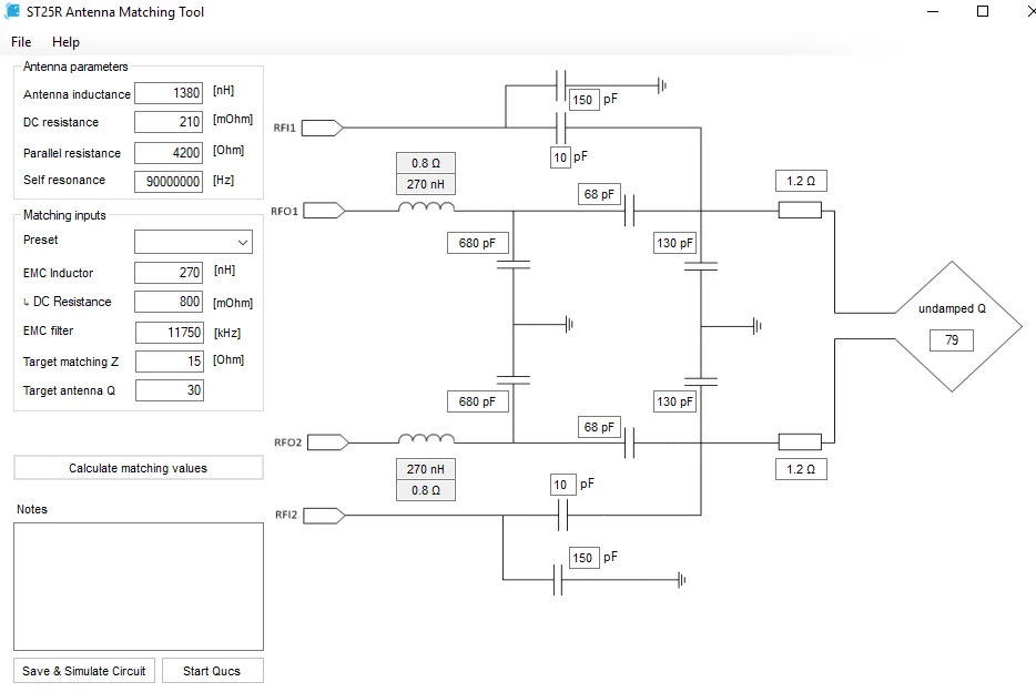

Hzhao.2186
Nov 29, 2019 8:47 AM UTC
Hi Travis,
Thanks a lot for your reply. This is some inputs and test set up:
Could you point out whether there is any mistake above?

Travis Palmer
Nov 29, 2019 9:39 AM UTC
Hello Sky,
all your inputs in theST25R Antenna Matching Tool look valid.
One small hint about measuring the Voltage on the RFI: Your scope probe (tip and GND-connection) is
doing a big antenna itself. It will pick up the H-Field of the Reader and add or subtract if from the Voltage on the RFI's. Its recommended to use a N4838A ground spring. Using it, you can measure both RFI voltages referenced to J301.
The easiest way to measure the RFI voltage, is to use the direct command "measure amplitude". You should setup the capacitive voltage divider to achieve ~2.7Vpp on the RFI.

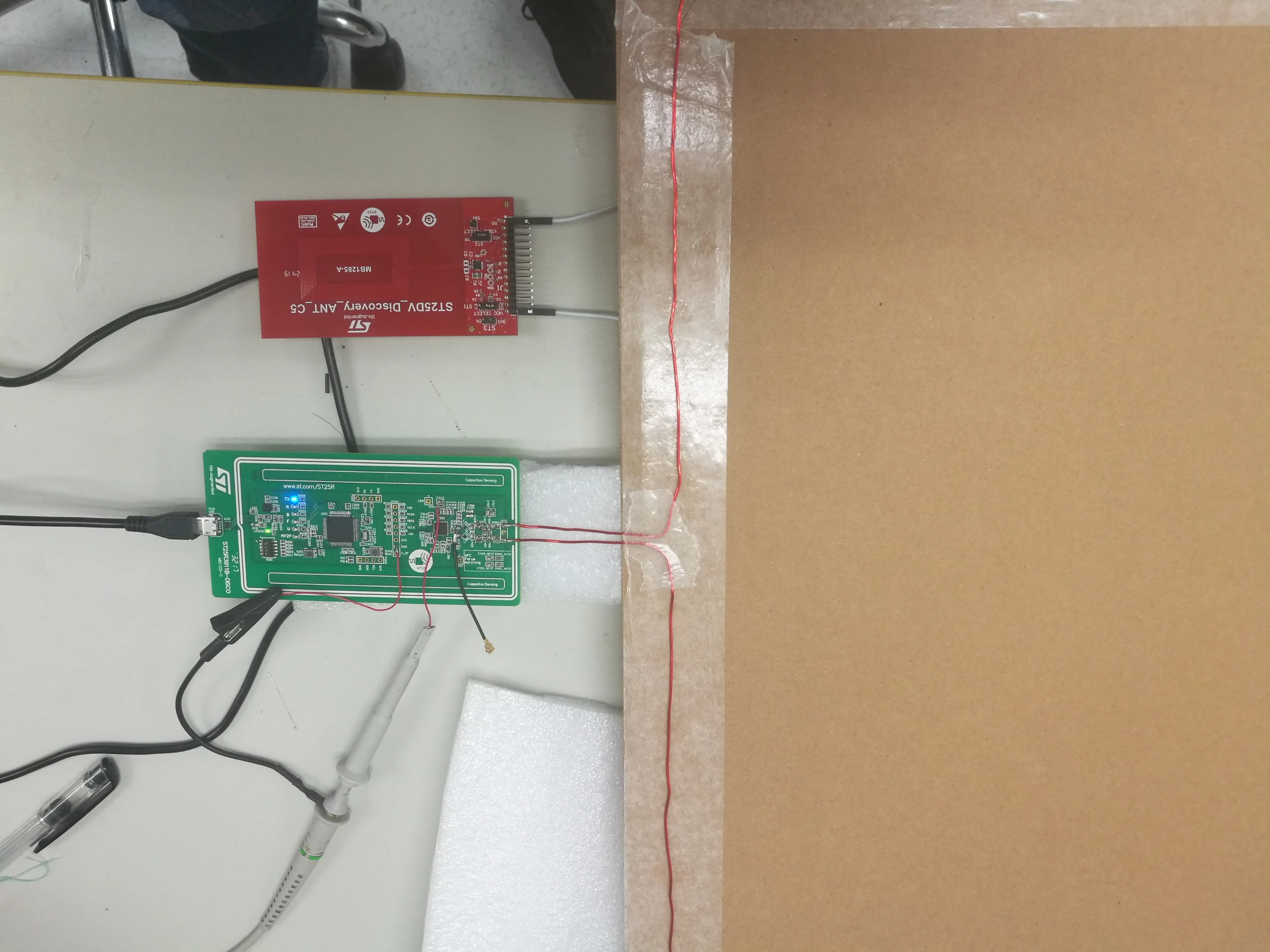

Now i can achieve the reading distance about 22cm with the ST25DV_Discovery_ANT_C5 tag,but difficult to improve more,
I have use the ground spring to get the capacitive voltage divider to 2.7Vpp on the RFI---change the C401&C412 to 220PF+27PF;
I am not very clear about the pick up coil, and how to use it;

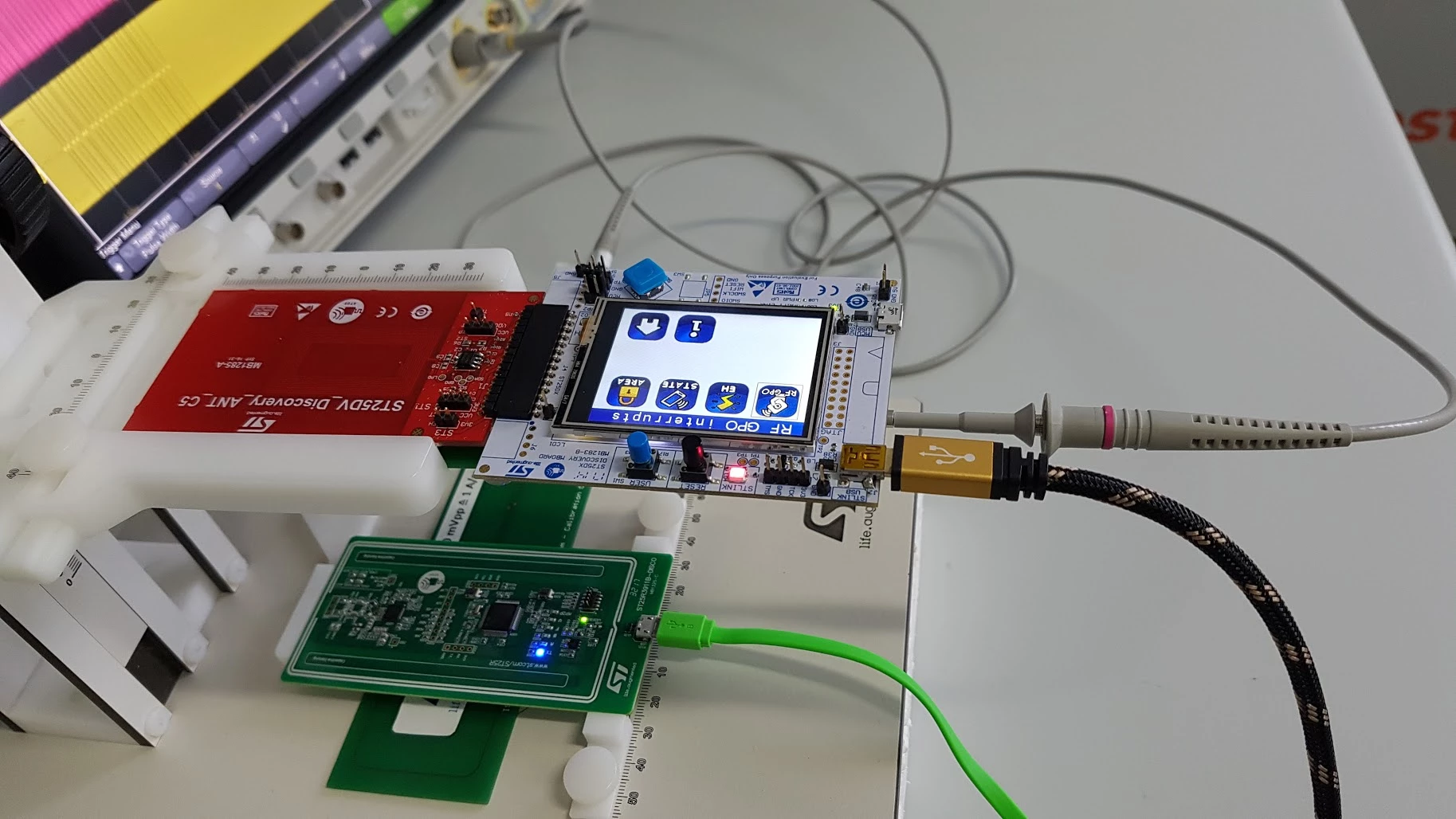

Travis Palmer
Dec 3, 2019 1:02 PM UTC
Hello Sky,

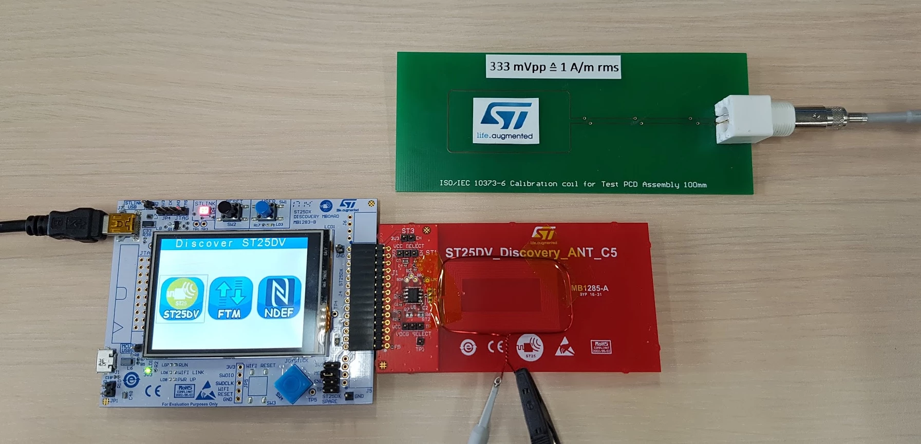

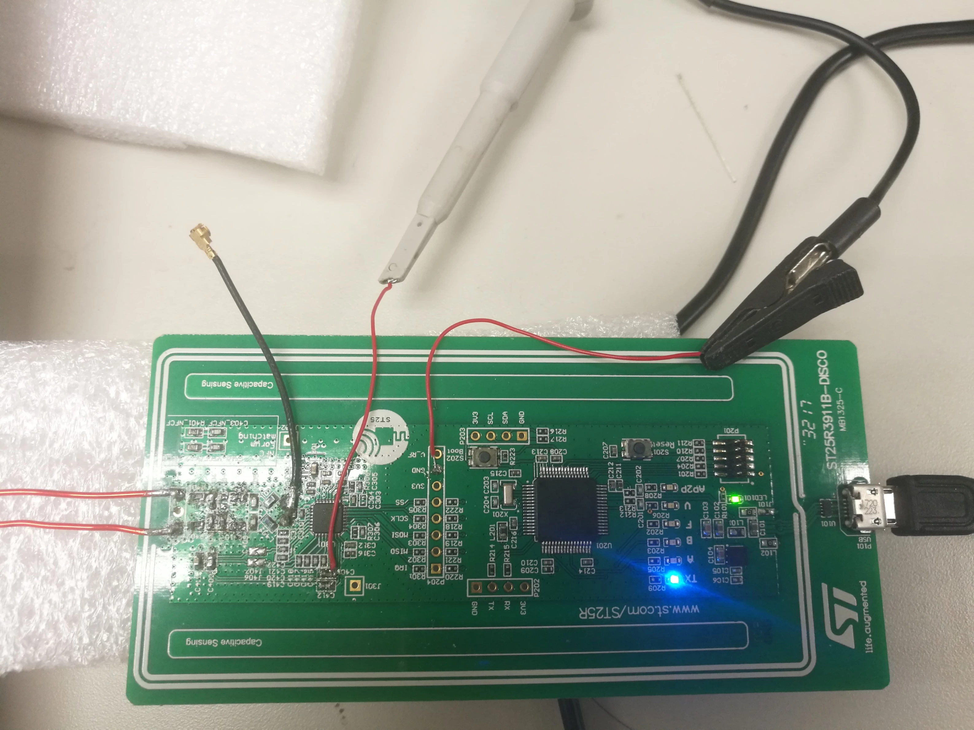

I usually use two pick up coils. One is close to the reader and used for triggering my scope, the second one is used to pick up the cards response.
You can either use a self made pick up coil (red wire tapped to the ST25DV_Discovery_ANT_C5 PCB directly) or an ISO Calibration coil (green PCB).
Both methods should use a high impedance probe to connect to the scope.

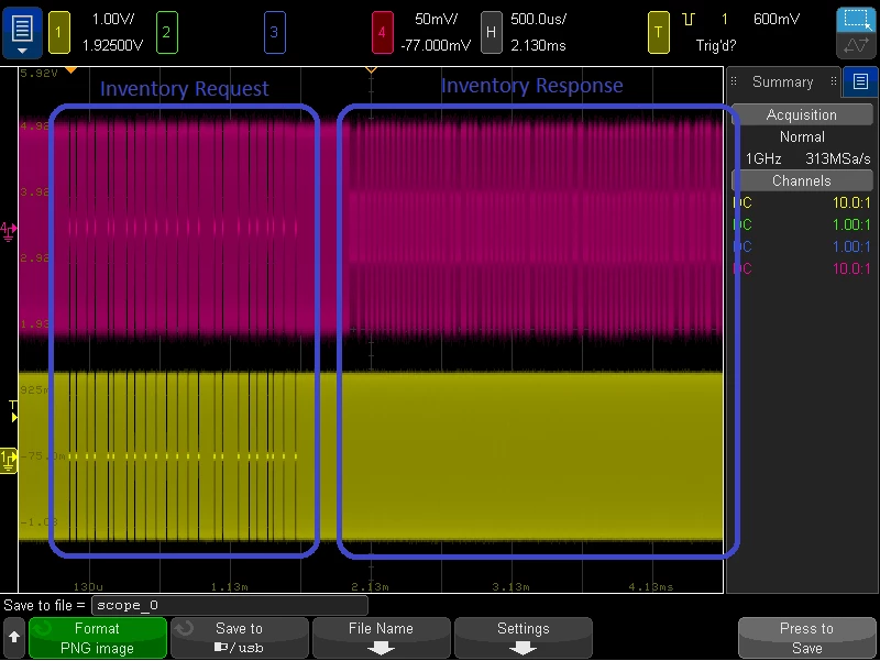

This is my lab setup for such investigations:
The yellow channel is recorded via the pick up coil close to the ST25R3911B-DISCO board. You can clearly see the inventory request command sent by the reader. The inventory response is already very small and cannot be seen with bare eye anymore. Still the reader can decode the response.
The red channel shows the signal recorded very closely to the tag. We can therefore clearly see the request sent by the reader and also the response sent by the ST25DV_Discovery_ANT_C5 tag. It shows the H-Field close to the tag. 0690X00000AtEyKQAV.png
If you now increase the distance between reader and tag, either the reader stops seeing the tag (sensitivity limited) or the tag stops responding (power limited).
On your setup, the reader antenna is very big and the tag antenna is very small. This means, there is already a bad coupling between the two antennas. The coupling influence both factors:
The power transferred from reader to tag and the load modulation amplitude (LMA) the tag can do.
In your case, I would recommend to increase the coupling by increasing the tag antenna size. Using a ID1 size antenna should already boost your results.

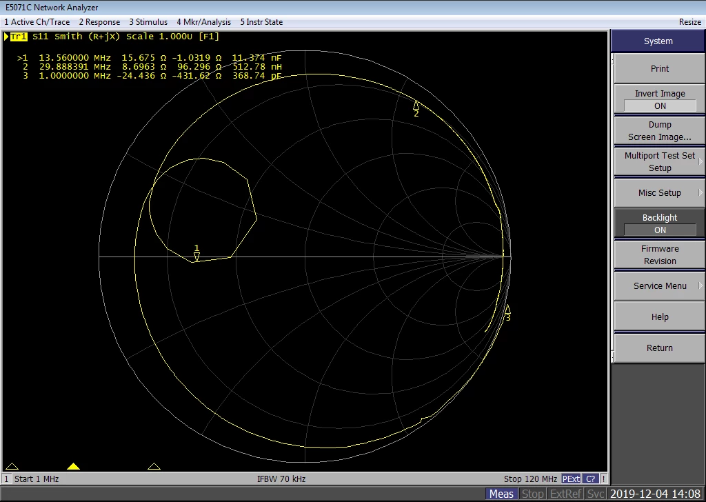

"And is it the impedance more close to pure resistance, the performance will become better?"
What is your current matching impedance? can you add a VNA smith plot?
"Does the values of matching circuit mast be same? eg.C410=C403 , C408=C406"
Yes, the series caps (C410 = C403) and the parallel caps (C408 = C406) should have the same value. otherwise your matching and loading of the chip will not be symmetric.

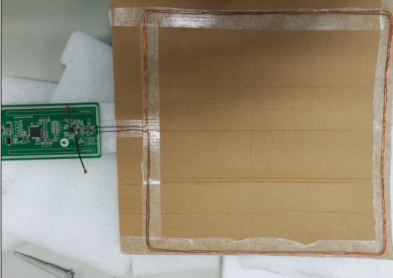

Hzhao.2186
Dec 4, 2019 4:15 AM UTC
Hello Travis,
Thanks a lot for your detail reply!
I have tried the smaller coil 25*25cm(2 turns) with the smith chart and change the received settings as below:0690X00000AtGcLQAV.png0690X00000AtGaZQAV.png0690X00000AtGaPQAV.png
Now the maximum reading distance is 25cm, do you have any other suggestions for improve the reading distance, such as add power... or this is the limited distance for my case, actually the tag coil size can't be increased more...
Another question is the coaxial cable connected to VNA, did i need disconnect the circuit behind?
Thanks.
Travis Palmer
Dec 5, 2019 7:52 AM UTC
Hello Sky,
Still the question is, if the tag stops replaying to the reader command, or if the reader does not see the tags response.
If the tag stops replaying, we can bypass the internal regulator and decrease the matching impedance to 6-8 Ohm.
If the reader does not see the response anymore, we need to look at the internal receiver signals to optimize the settings.
Do you have the trim pins connected? At 15 Ohm matching impedance and a high Q-factor it is most likely that the limit of 20V on the trim pins is exceeded.
The result might be, that the ESD protection is getting active and reduces the voltage / power on the antenna.
Your matching and VNA measurement looks perfect.

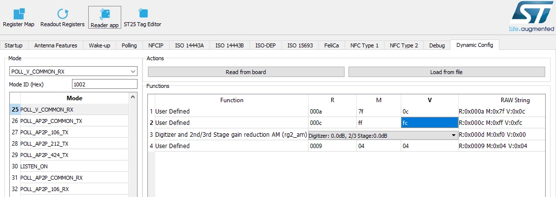

Travis Palmer
Travis PalmerBest answer
Dec 6, 2019 9:05 AM UTC
Hello Sky,

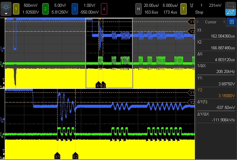

Yes i am confident that this can be achieved. Likely due to the bad coupling between reader antenna and tag antenna additional circuitry (amplifier, filter) might be required.
Internal receiver signals:
You need to connect to P301 (CSO) and P302 (CSI) on the bottom side of the board. There is a footprint for UFL connectors foreseen where a UFL to BNC or SMA cable could be plugged. You can also directly solder a cable to the pads. To capture a good signal, i recommend to remove / cut the traces leading to the capacitive patches (they could pick up some field).
You should then use a high impedance probe to feed the signals into the oscilloscope.
Referring to chapter "1.2.15 Test access" of the datasheet DS11793 - Rev 5:
By setting the registers as described in this section, you can e.g. output the analog signal of the AM channel and see how the digitizer decodes it.
several other combinations are possible as mentioned in Table 13.
Below you can see a Type A response showing:
Yellow: H-Field
Blue: Analog output of AM channel (before digitizer)
Green: Digital output of AM channel (after digitizer)
The screenshot shows a quite strong signal. After the first sub carrier pulses the AGC reduced the signal to a optimum level.
You can now alter filter and gain settings and instantly see their impact.
