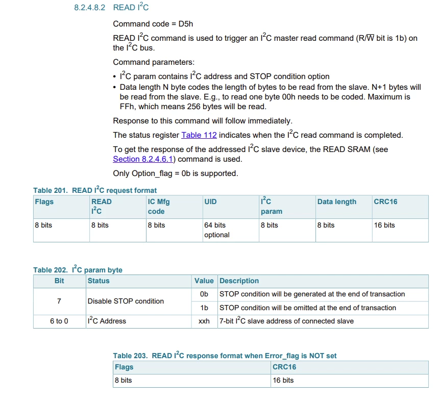

I think the manufacturer DS should indicate more conditions when this 0Fh is reported. I think 8.2.6.2 of its DS indicates that "received command or option is not supported".

So the Commands for ReadI2C and WriteI2C should be executed the exact same way using the rfal - right? Or am i understanding the rfal function wrong? rx / sizeof(rx) can be larger then needed - or might this lead to a problem?
So first i would write the ADC register i want to read out via WriteI2C and then immediately i would send a ReadI2C with the amount of data to read from the ADC (speficied by the ADC register).
// I²C bridge (0xD4/0xD5)
uint8_t tx[2] = { i2c_slave_addr, data_length_rx };
uint8_t rx[data_length_rx ] = {0};
ReturnCode rc = rfalNfcvPollerTransceiveReq( 0xD4,
RFAL_NFCV_REQ_FLAG_DEFAULT, // 0x02
0x04, // NXP mfg code
uid, // addressed mode
tx,
sizeof(tx),
rx,
sizeof(rx),
&rcv );

rx size should be at least two bytes bigger then needed when using ST25R39xx devices (as RFAL is internally using the Stream mode and does need to receive and check CRC in SW). It can be even bigger.
