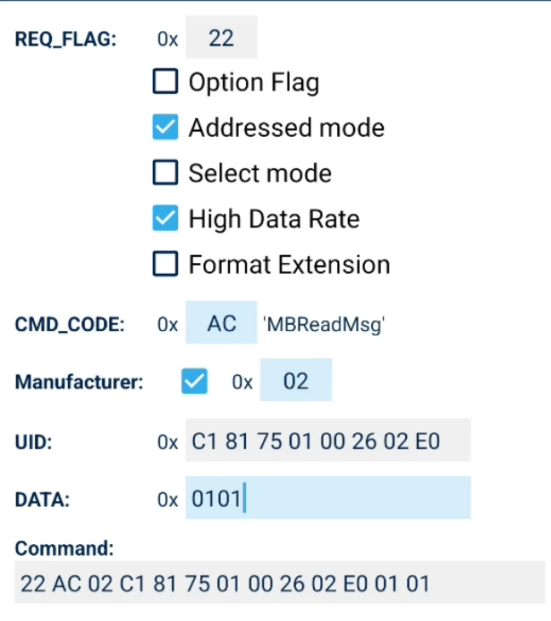

Hello
You have to build the command according to the Databrief, to simplify, you have to use and setup following parameters:
Request parameters:
• Request flag
• UID (Optional)
• Pointer (start at 00h)
• Number of bytes is one less then the requested data
Please refers to datasheet on st.com for parameters details
ST25DV16KC - Dynamic NFC/RFID tag IC with 16-Kbit EEPROM, and fast transfer mode capability - STMicroelectronics page 123 for exemple.
Before reading the message, you probably need to know how many bytes are available, you can use Read message Length command ...
For exemple, the following custom cmd, read mailbox, if a message has previously been posted...
_legacyfs_online_stmicro_images_0693W00000bhsOfQAI.pngHope this will help, building customs cmds.
BR, FB

Hello
Android apps, but you are working with the iOS one, you should probably have a menu just before CoreNFC one with Custom Commands which is similar to the android one.
Nevertheless, it is the same way of doing you should provide correct full command data applicable to the context and command description provided in the Datasheet.
