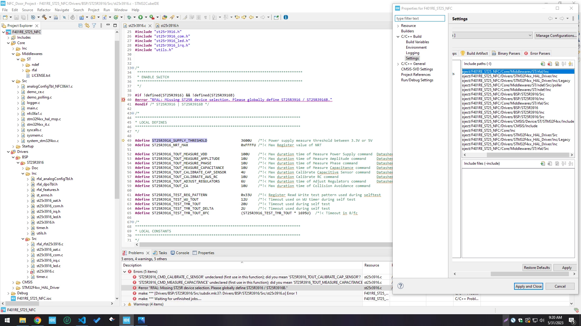

Hello dear developers,
I am currently working on NFC for the project for my graduation project. First of all, I would like to learn how X-NUCLEO-NFC06A1 works. Therefore, I tried to run the expansion board on the NUCLEO-F401RE and copied the files included in the sample projects run by NUCLEO-L053R8. But I couldn't get the expansion kit to work.I would appreciate if you share with me which files I should upload to which files of the project in X-NUCLEO-NFC06A1. Have a good day & work.

Ulysses HERNIOSUS
May 30, 2023
please have a look at bringup-nfc06a1-on-nucleof446re which is very similar.
Best Regards, Ulrich

Hi Ulrich,
I've already tried exactly the same way but failed. I am attaching a screenshot of my project errors and path below.

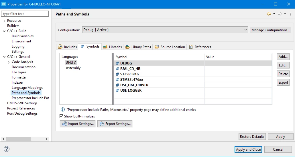

Ulysses HERNIOSUS
May 31, 2023
wells as the line tells you: You need to define ST25R3916 (when using NFC06) in the global properties. Likely something like:
Best Regards, Ulysses
Pingstech
PingstechAuthor
May 31, 2023
Thanks to both of you for your recommendation. I will try to run the project, if I am successful, I will share the result. Have a nice day.
