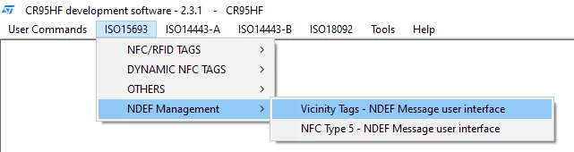

My M24LR04E Discovery Board is not showing up when using the CR95HF Development Software's "Auto Detect tool" or the "Vicinity Tags - NDEF Message user interface" tool. In these tools the tag just doesnt show up as seen when you scan for tags. In the "Tag Detection tool" however, the tool is shown (however this isnt very usefull, it only shows that its a ISO15693 tag). The M24LR04E Board itself still has the functionalities to show the voltage of the field or to show the temperature sensor output. The NDEF message however reads:
"NOT A NDEF TEXT MESSAGE"
How this (probably) happened:
I was playing around with the discovery board for my internship, to get to know NFC. I have installed the CR95HF Development Software that goes along with the M24LR04E Discovery Kit.
0690X000009jCDhQAM.pngWhen playing around with the Vicinity Tags - NDEF Message user interface, I could read and write away NDEF messages to the M24LR04E Discovery Board.
0690X000009jCE1QAM.pngAfter that I opened this program: the ISO15693 User Interface M24LR04E. Here I started playing around (my fault, I didnt know really what I was doing). I think I may have overwritten data here that wrecked the functionality of the M24LR04E Discovery Board, or locked something with the sector password stuff. Honestly Im not sure what I did.
Is there any way to fix this/reset the M24LR04E Discovery Board to starting conditions? I cannot seem to fix this or find a way to reset the board.

When trying to use the ST25PC-NFC software, I tried to write text NDEf data. When trying to write the data, I have to give a password. I do not have a password. Maybe I have accidently set up a password? How do I remove the password or reset the tag?

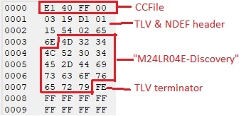

​Hello,
Has suggested by Brian, your CCFile is probably corrupted.
Here is the value of memory inside the M24LR04E discovery board "out of the box":

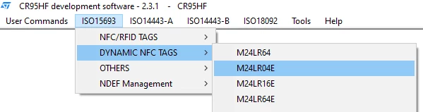

You can check the content of your memory's tag using the CR95HF GUI:
  • go in ISO15693->DYNAMIC NFC TAGS->M24LR04E
  • then in the User Mode tab, select addresses from 000 to 00F and click on "Read Single Block"
You should now see the content of your tag's memory.
CCFile is the first 4 bytes of the memory at address 00. Then comes the NDEF file, terminated by "FE"
You can restore the content of the tag's memory by two ways: using the ISO15693->DYNAMIC NFC TAGS->M24LR04E interface and directly write correct values in the memory, or use the ISO15693->NDEF Management->Vincinity Tags - NDEF Message user interface to directly write CCfiel and NDEF message.
If using the ISO15693->DYNAMIC NFC TAGS->M24LR04E interface, you will need to send 'Write Single Block" commands with correct data and correct addresses in memory.
