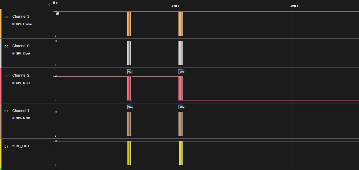

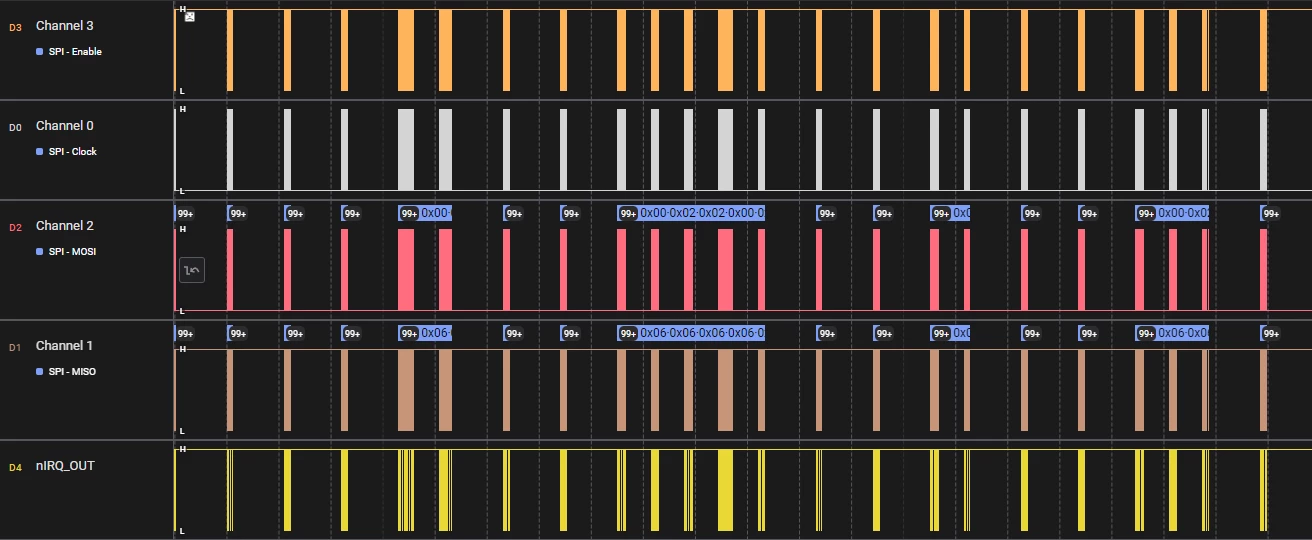

Hello, I am testing the st25r95 with the X-nucleo-nfc03a1 attached to a nucleo-g0b1re, I am successfully running the democycle and reading nfc tags.
In my application I have a limited amount of flash available (<20 Kb) and also,
I only need to detect tags which have the ISO14443A (NFC-A) protocol. To reduce
the amount of flash. One thing I have done (as suggested in another post “How
to minimize flash usage�?) is to set in platform.h -> RFAL FEATURES
CONFIGURATION -> RFAL_FEATURE_NFCV to false. That indeed reduces the flash
usage, but then the communication with the st25r95 stops.
With all the functions enable:
0693W00000aI6ylQAC.pngRFAL_FEATURE_NFCV to false:
Only initialization.
0693W00000aI6yvQAC.pngCan you give some advice about how to properly deactivate the protocols I don’t need?

    I guess your application is based on X-CUBE-NFC3.
    When a technology (RFAL_FEATURE_NFCV) is deactivated (set to false), one must make sure that the discParam.techs2Find does not include this technology in demoIni().
    In your case, the discParam.techs2Find in demoIni should be modified to:
    discParam.techs2Find      = RFAL_NFC_POLL_TECH_A;

    JSope.1
    JSope.1Author
    March 3, 2023
    Thank you, modifying the discParam.techs2Find solved my issue.
    Regards.
