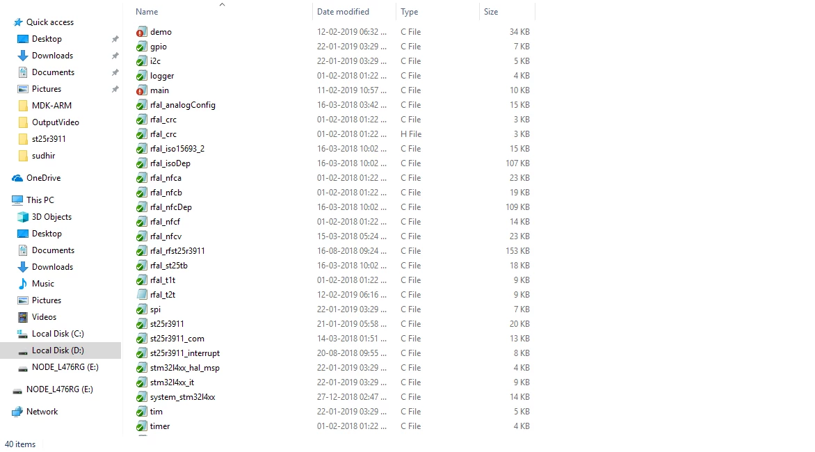

February 12, 2019
Hi Ulysses,
I have included the files shown in image.
On 12-02-2019 06:31 PM, ST Community wrote:
RP_it
RP_itAuthor
February 12, 2019
I used all the files from STM32CubeExpansion_NFC5_V1.3.0 package. Only rfal_t2t files from ST25R3911B_DISCO_FW_v1_2_8 package.
Ulysses HERNIOSUS
February 26, 2019
Please use all the rfal files from ST25R3911B_DISCO_FW_v1_2_8 package to have a consistent package.
