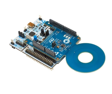

how to program st25r3911b which is connected to st25dv discovery board
I am using st25dv discovery board and st25r3911b reader. i need to program details which is shown below to the reader and the tag should visualize the details, can you guys help me?
struct{
char CustomerOrderCode[24];
char InternalFactoryCode[24];
char ProductName[24];
char HWVersion[24];
char SWVersion[24];
char ManufacturingDate[12];
char ManufacturingTime[12];
char QualityControlPersonID[24];
uint32_t ContinuityCounter;
} LabelContent;
Thankyou

Brian TIDAL
Jun 5, 2020 3:35 PM UTC
if my understanding is correct, you would like to write the LabelContent buffer into the tag eeprom memory thanks to the reader? I suppose as well you have a X-NUCLEO-NFC05A1 ST25R3911B expansion board connected to an STM32 nucleo board and that you have the X-CUBE-NFC5 firmware package.
First, you should make sure the structure is a packed structure. See __packed struct in Keil or IAR compilers, or struct __attribute__((packed, aligned(1))) in gcc compiler.
Then you can use rfalNfcvPollerWriteSingleBlock() or rfalNfcvPollerWriteMultipleBlocks() to write blocks inside the tag eeprom memory.
If you rather plan to write inside the ST25DV mailbox, you can have a look to https://community.st.com/s/question/0D53W000004m5e4SAA/can-anyone-provide-an-example-of-api-rfalst25xvpollerreadmessage.
Rgds
BT

Brian TIDAL
Jun 23, 2020 9:49 AM UTC
Hi
Can you clarify your exact setup
Can you confirm you would like to write the LabelContent into the tag memory thanks to the ST25R3911B reader and then read the tag memory content through the I2C interface? Do you need to have LabelContent in a permanent storage (tag eeprom) or just in the ST25DV mailbox.
Rgds
BT
Raj1
Raj1Author
Jun 23, 2020 1:07 PM UTC
hello,
I changed hardware setup. right now i got X-NUCLEO-NFC04A1 board and android phone with st25 nfc app. I need to write the reader data to tag eeprom and then to the i2c interface like you said. I need some help materials or tutorials .
Thank you
with regards
vignesh raj
Brian TIDAL
Brian TIDALBest answer
Jun 23, 2020 1:22 PM UTC
for the X-NUCLEO-NFC04A1, a firmware package with examples is available on st.com (see X-CUBE-NFC4 package and UM2239 User Manual).
For the ST25 NFC Tap app, see the MEMORY tab for the various Read/Write/Dump features.
Rgds
BT
