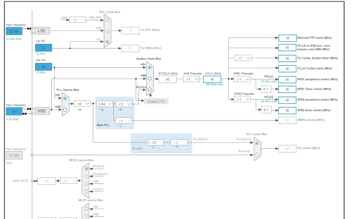

It is likely that the SYSTICK on your board is not accurate or does not have the proper 1ms value. Do you use an HSE crystal oscillator or an HSI internal RC oscillator? Just toggle a GPIO inside the SysTick_Handler and probe it with a scope to check the value of the SYSTICK.
Rgds
BT
October 5, 2023
I use an HSI internal RC oscillator. I check SysTick_Handler and it seems okay.

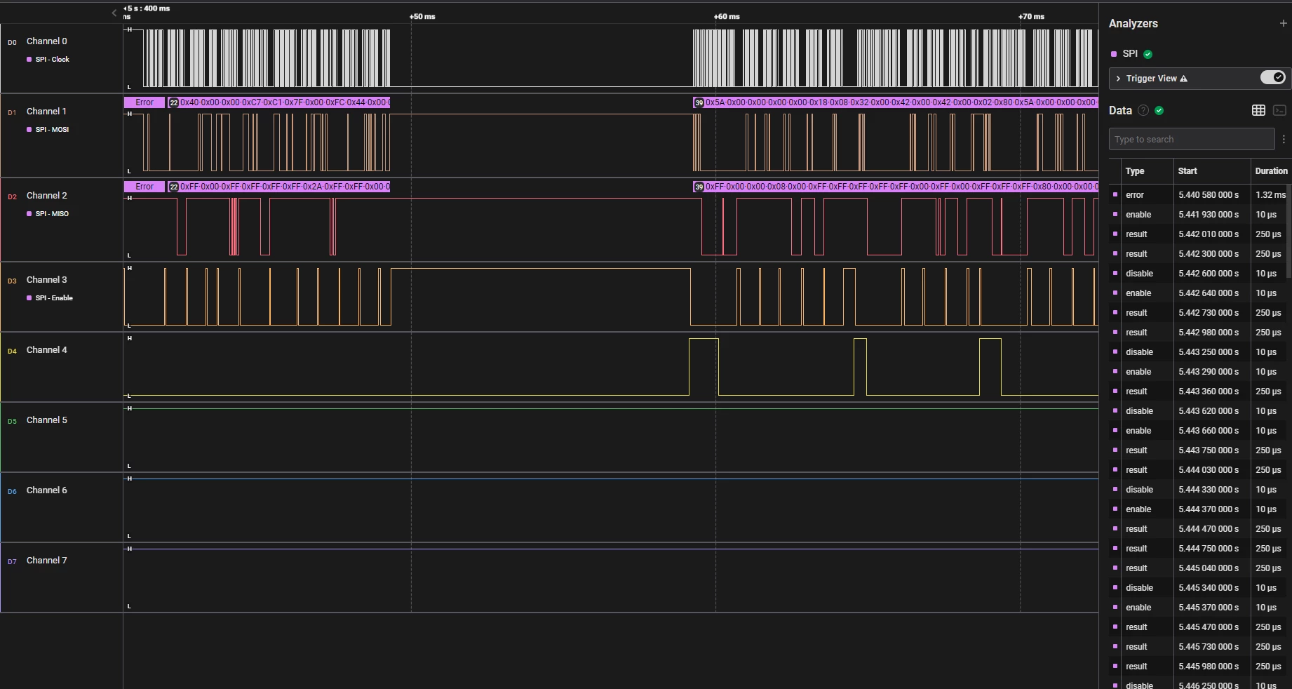

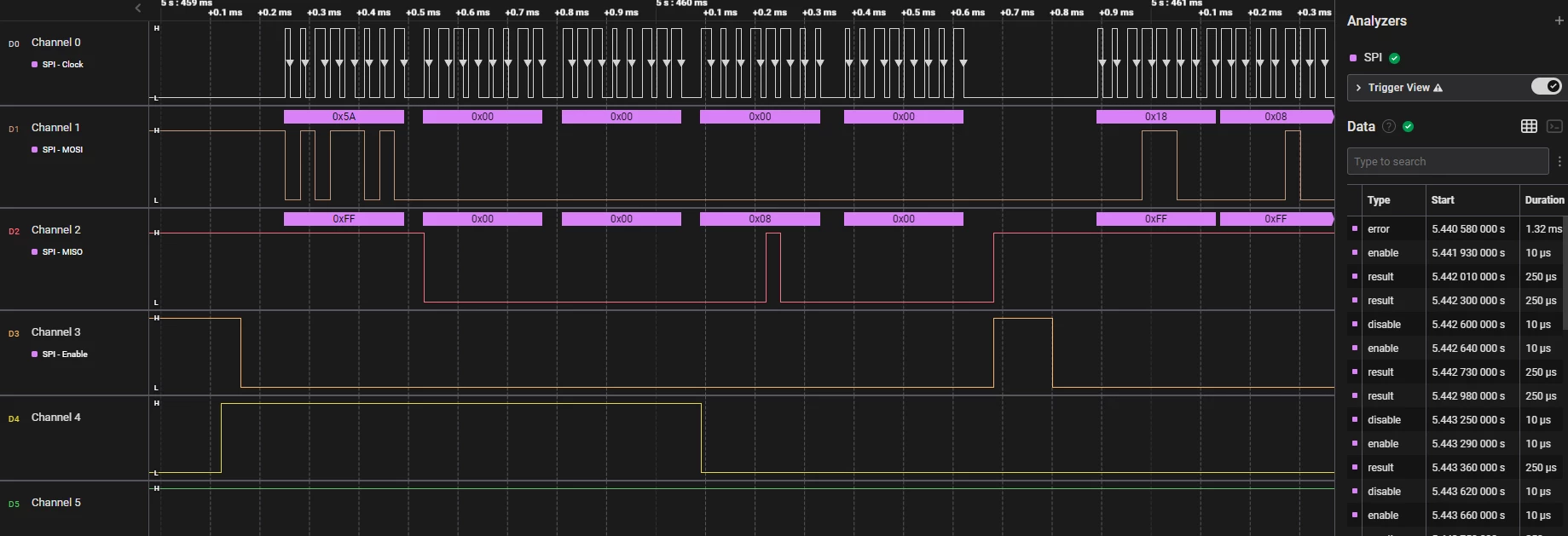

can you connect a logic analyzer on the SPI (CLK/MISO/MOSI/SS) + IRQ_ST25R + SYSTICK GPIO (toggling every 1 ms) and send me the trace? what is the duration between the Start General purpose timer direct command and the IRQ_ST25R  interrupt?
Rgds
BT
October 5, 2023
I hope understood correctly.
Rgds
ZD
Brian TIDAL
October 5, 2023
the SPI clock seems to be around 40kHz (if I am not wrong, this is usually 5MHz in our demos). Do you confirm? The reading of the interrupt status takes 1.5ms to be compared with the 2ms margin for the General Purpose Timer expiry in the SELFTEST_TIMER. Any reason to have such a low speed on the SPI? What is your MCU clock configuration? Make sure to have the proper SPI prescaler in order to reach ~4 MHz or increase the margin in the SELFTEST_TIMER or disable the SELFTEST_TIMER.

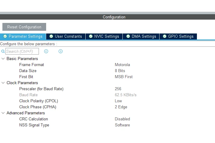

October 6, 2023
I use these values. I tried many options and this is the best result.
If I use the high speed value, I cannot see SPI communication in Logic Analyzer.
Rgds
Brian TIDAL
October 6, 2023
"If I use the high speed value, I cannot see SPI communication in Logic Analyzer." Well, make sure to properly configure your Salae device (go to device settings and configure the proper sampling rate in order to be able to capture SPI at 4MHz i.e. > 20 M sample per second)
A 62.5 kHz clock for the SPI causes transfer duration that is not really compatible with a 2 ms margin to check the accuracy of the systick in the SELFTEST_TIMER... Again I would recommend to use 4MHz (prescaler 4 for a SYSCLK of 16MHz).

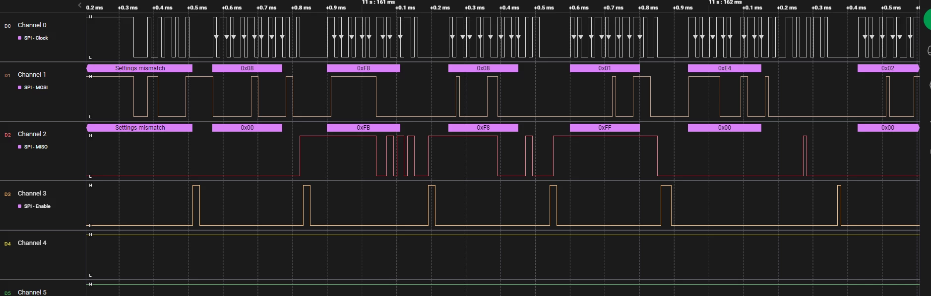

October 9, 2023
You can access the file from this link.
Rgds
ZD
Brian TIDAL
October 9, 2023
make sure to follow Salae recommendation regarding the sampling rate (https://support.saleae.com/faq/technical-faq/what-sample-rate-is-required). With a SPI clock at 4MHz, a 8MS/s sampling rate is not enough to provide a reliable trace: some SPI clock ticks are randomly lost as in the following screen shot
Can you confirm that ST25R3916_TEST_TMR_TOUT has not been modified (this is 20ms in the genuine code)?
Also can you confirm that a 27.12 MHz crystal is being used on your custom board?

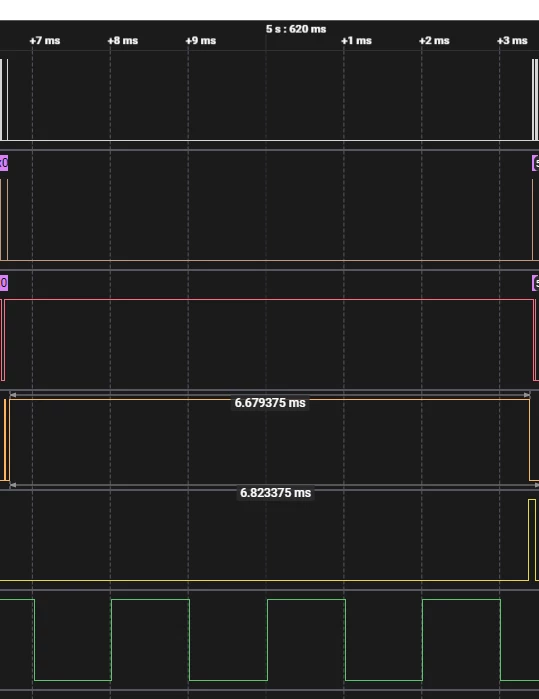

I cannot exceed the MS/s value. I installed extensions for STMicroelectronics - ST25R3916 (B) on Logic 2. I used it and added a capture in this link.
Brian TIDAL
October 9, 2023
Hi;
the General Purpose Timer is started with a value of 2C38h i.e. 6.68 ms
Therefore the GPT expires 6.68 ms after the E0h direct command:
So, compared to the original code, the ST25R3916_TEST_TMR_TOUT has been modified.
