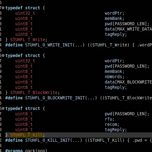

I try to Kill a TAG, I'm using different configurations but don't obtain a different answer.
I believe if a Kill a Tag, It's not more possible for my reader to identify her, but after I using the kill command my Tags still read by my reader.
I want to understand whats means the parameters RFU and RECOM in the struct of the kill. What the values that parameters expected?
What means the error "ERR_GEN2_REQRN"?
Best Regards.
Best answer by Bart Herse
Hi GPaiv.1,
did you assign a kill password before sending the Kill command? The Kill command does not work for a zero password.
RFU means reserved for future use. The kill command has a 3 bit wide field which is called RFU and these bit shall all be zeros.
RECOM is a dormant piece of code as in the latest Gen2V2 or ISO 18000-63 standard recommissioning of tags is not supported anymore.
ERR_GEN2_REQRN defines the return code in case an error happens while sending the ReqRN command.
