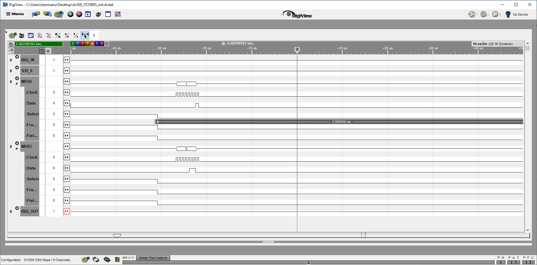

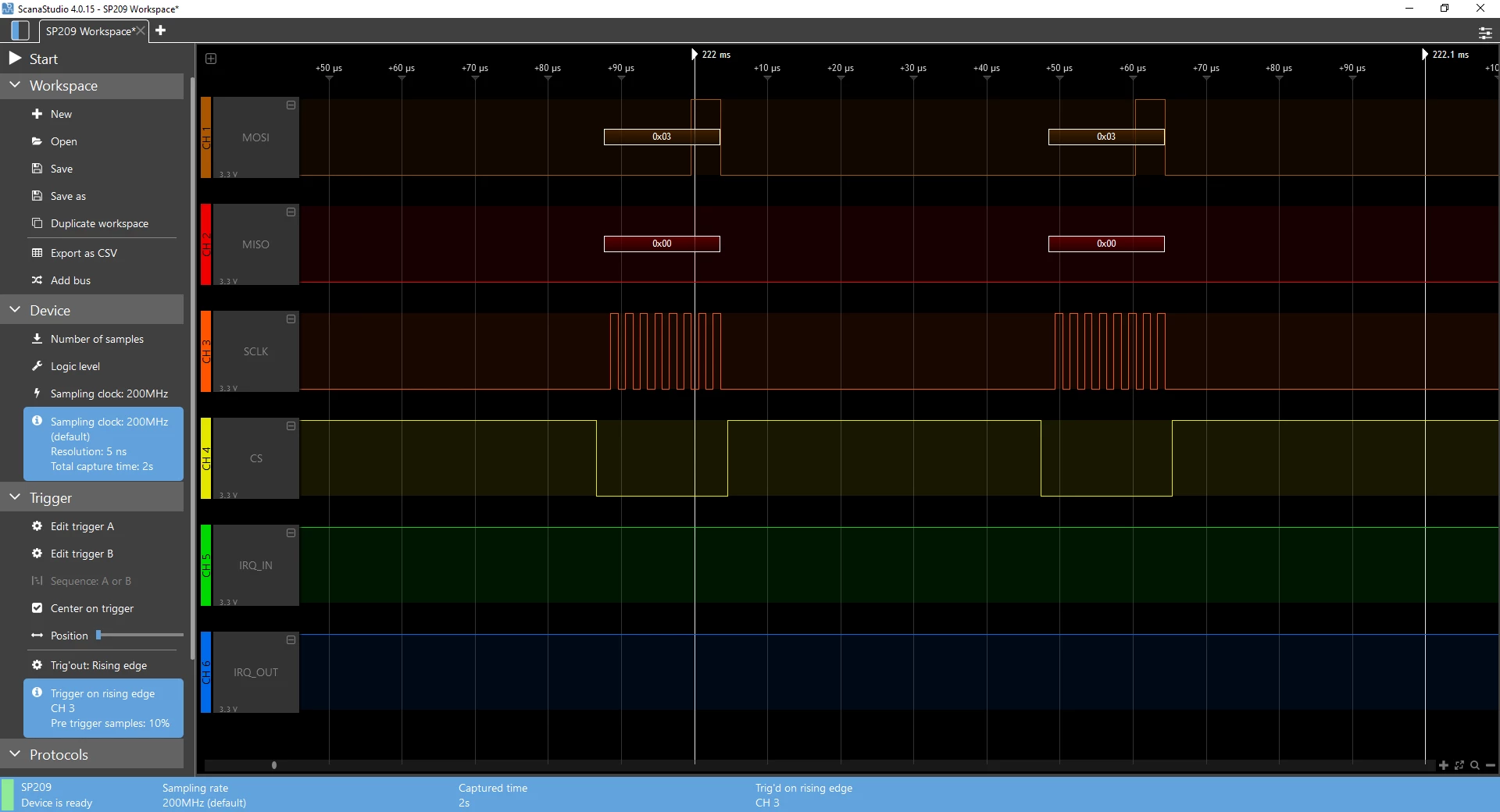

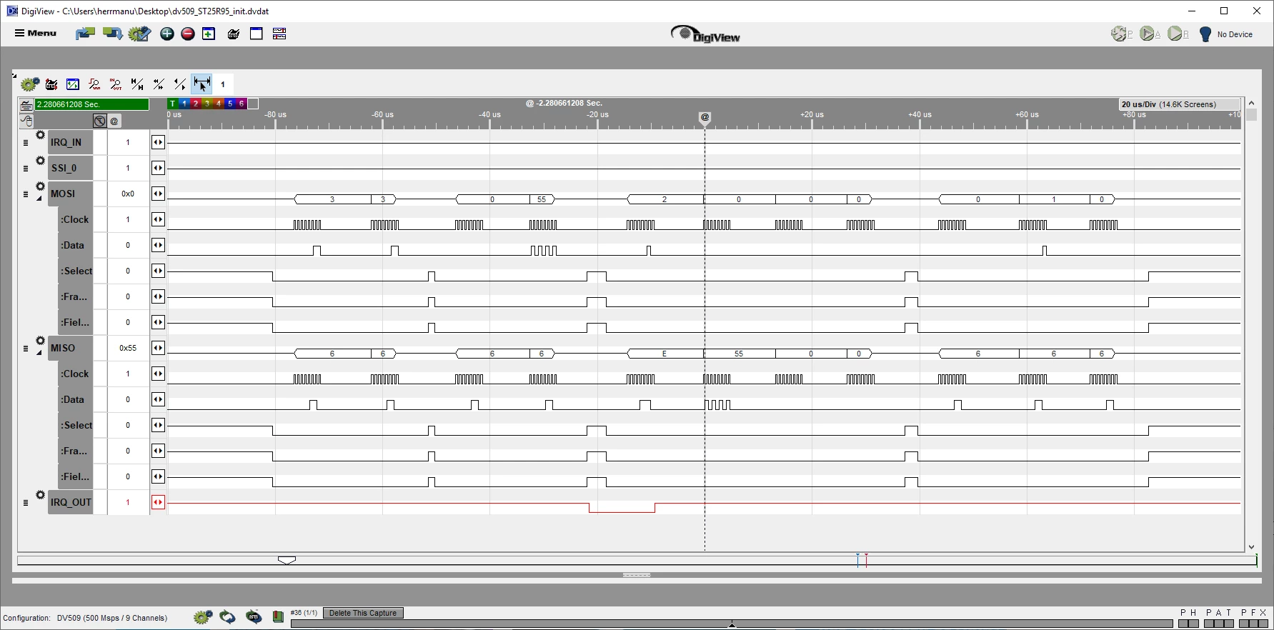

    Hello Ulysses,
    I have reviewed the X-CUBE-NFC3 settings and I have set mine the same.
    Also I have added logic analyzer traces of my connection. Since I am unable to get all the signals at the same time I will have my SS (CS) signal as the trigger on both occurances. The first screenshots (SPI Interface) are the standard MOSI/MISO/CLK and SS signals. The other screenshots are the other signals IRQ_IN, IRQ_OUT.
    After about 2 ms (Even though I think these times are not really significant) the G070B will start retrying the same routine for a few times. I think it is set in the code that it has to attempt it a couple of times.
    Kind regards,
    Joey
    Ulysses HERNIOSUS
    August 20, 2020
    Hi Joey,
    I think your CS line is not properly controlled (maybe configured to be controlled by HW block but I think we need it software controlled):
    I see two single bytes <03> <03> being written in your case and in our software this is written in one frame: <03 03>. I guess this can be the reason.
    Please check.
    Regards, Ulysses
    Ulysses HERNIOSUS
    August 20, 2020
    didn't see SSI0 in your traces. Please check that as well.
    Ulysses

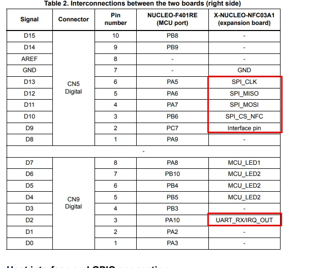

    JNieu.1
    JNieu.1Author
    August 24, 2020
    Hello Ulysses,
    I have set my CS line to be controlled by software, (assuming it's the setting called Hardware NSS Signal which I set to Disable).
    Which signal do you mean with SSIO?
    I've added two screenshots, the first screenshots shows the same as last time but now in a single screenshot as I got my hands on a Logic Analyzer with more ports. The second screenshot is the pin layout as given in de user manual for the CR95HF.
    Kind Regards,
    Joey
    Edit: Also on advanced parameters the NSS Signal Type is set to Software.
    Brian TIDAL
    Brian TIDALBest answer
    August 24, 2020
    The CS signal is not properly driven: it should be low during a whole frame (e.g. low when sending the 03 03 polling command, in your trace the CS goes high in between). Make sure to have
    • Hardware NSS Signal: Disable
    • NSS Signa Type : Software
    • PB0 being defined as GPIO Mode: output push-pull , GPIO output: high and properly mapped to ST25R95_N_SS_PIN/PORT in platform.h
    SPI interface is not properly selected: in your IOC project, the SSI_0/Interface pin is not set. It should be 1 (see table 4 in the ST25R95 DataSheet). Make sure to have PC7 being defined as SSI_0 and being high.
    The SPI baud rate is exceeding the max ST25R95 SPI clock frequency. It should not exceed 2Mbits/s (current value is 8...). Make sure to update the presscaler to 8 (==> Mbits/s) or 16 (==> 1 Mbits/s).
    Rgds
