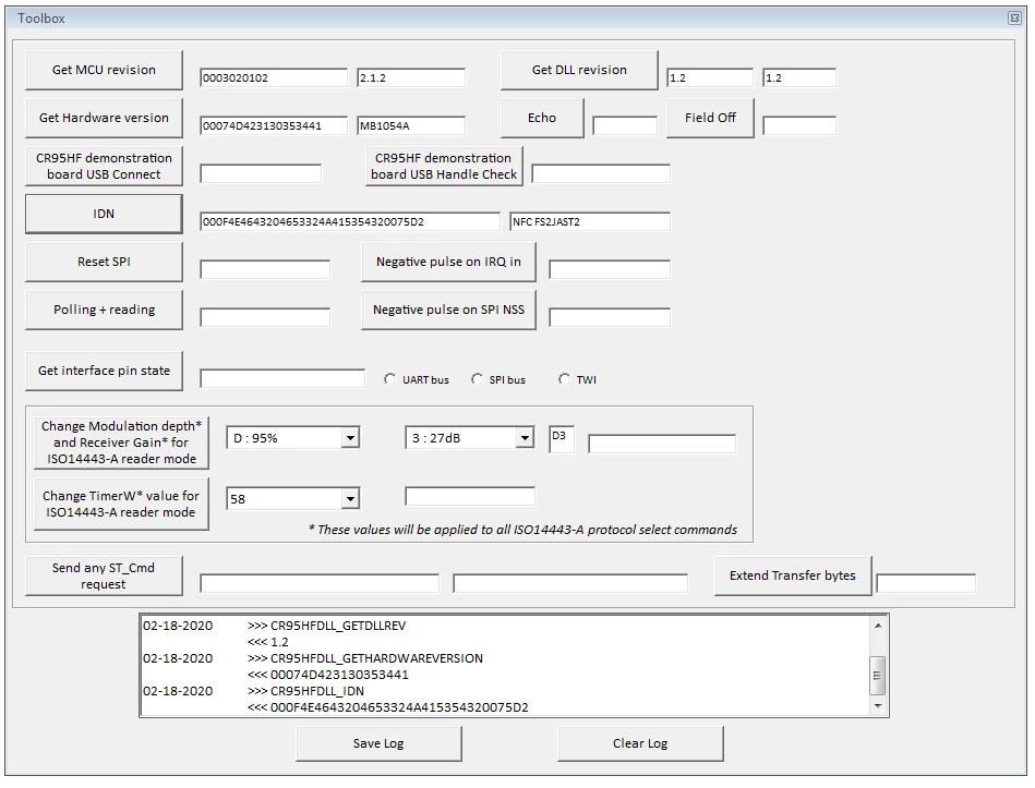

    It could be that your CR95HF reader board has an old firmware version that is not compatible with the PC software.
    See if you can get the reader's firmware version from the CR95HF software.

    February 18, 2020
    Hello Damien,
    here is all information available trough the toolbox option.
    Is there a firmware update available?
    Could not find anything in the download section.
