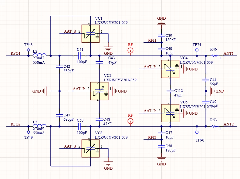

   I have a ST25R3916B project that is working fine, largely based around the demo_polling.c application. We use one '3916B and switch between different antennas. Each time we switch obviously the RF characteristics change a little, so I'd like to calibrate the antenna. I found the function st25r3916AatTune() but I don't see any example of how to call it and set the parameters.

To add more detail:
a. I did read AN5322 about antenna tuning, but just need more information about how to incorporate into the demo application.
b. Hardware follows X-NUCLEO-NFC08A1 with the series and parallel variable capacitors as LXRW0YV202-059 (100pF - 200pF)
c. Antenna multiplexer is after the RF match circuit (multiplexer attaches to ANT1 and ANT2, below)

I read through AN5322 and it mentions the struct but gives no example or units of what the values should be. We're using the 5 variable capacitor topology in  x-nucleo-nfc08a1 with the LXRW0YV201-059 (100pF - 200pF) variable capacitors. The struct is poorly documented, giving no examples of what the values should be set to ideally, nor does it give the units. I also see the defaultTuningParams but again, it doesn't say what each field means.
1. Are aat_a_min, aat_a_max, aat_b_min, aat_b_max in picofarads? Or voltage? It is not specified.
2. Given a range of 100pF - 200pF, what would be a good start value?
3. What would be a good stepWidth to use?
4. What are recommended values for phaTarget, phaWeight, ampTarget, ampWeight?
Finally, we're under pressure to get this into production - is there a way that we can privately share schematics and layout? Thanks

Ulysses HERNIOSUS
May 3, 2024
ad 1) These are the inputs for the algorithm in terms of values for the Antenna tuning control registers of the ST25R3916.
ad 2) It depends on your matching and what you want to achieve. By default I assume that you have varicaps on both pins and that you want to put the mins to 0 and the maxs to 0xff.
ad 3) It again depends how accurate you want to vs the time you want to spend. If providing NULL we are starting in the middle (128;128) and with a step size of 32 and dynamic steps which should quickly converge.
ad 4) It depends on your matching. The default config tries to mimic how the hardware algorithm on ST25R3911B was optimizing by default: Maximize amplitude and try to get phase close to 90deg. You can also put the weight for phase to 0 for optimizing only the amplitude to e.g. 2.5V (ampTarget * 13.02mV)
You can send a private message sharing layout and schematics but not sure if they will tell me as a SW engineer much. You can of course send a few results of the antenna tuning vs experienced range change for interpretation.
BR, Ulysses
