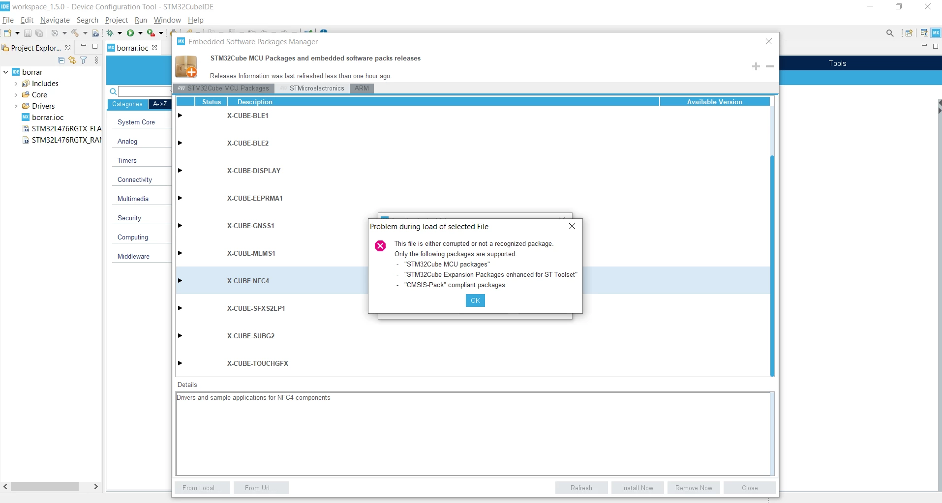

Hi there,
Is there any way to import X-CUBE-NFC6 software expansion into STM32CubeIDE ?
I've seen that there is an option to manage package extensions from local / url. The issue here is that on officials X-CUBE-NFC6 official website https://www.st.com/en/embedded-software/x-cube-nfc6.html an example project is provided, but the *.pdsc file to import the expansion into IDE.
Thanks for your time.

    Is really STM32CubeIDE or STM32CubeMX embedding this software package?
    The link you provide is the expansion pack, which was already out there (older versions though)
    We could import examples of NFC into our workspace but the IDE and the MX does not have the X-CUBE-NFC6 software package and Import "From local" fails.
    Rene Lenerve
    November 27, 2020
    Hi @VMach.1​ ,
    The NFC6 package I was referring to is the latest release which now includes project files for the STM32CubeIDE workspace (previously it was AC6). The NFC6 package will not be embedded into CubeMX, due to legacy support needed for the rfal middleware this package will not be aligned with all requirements needed by CubeMX.
    So to answer your first question
    "Is there any way to import X-CUBE-NFC6 software expansion into STM32CubeIDE ?"
    Yes you have now project files included in the package that you can import into STM32CubeIDE.
    And to answer your second question
    "Is really STM32CubeIDE or STM32CubeMX embedding this software package?"
    This package contains project files for STM32CubeIDE but not project files for STM32CubeMX.
    I hope that answers your question.
