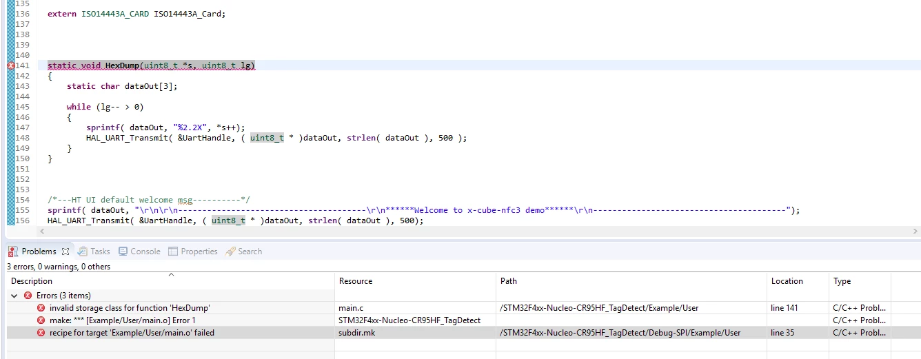

Okay i modify UIT msg code
  1. /*---HT UI msg----------*/
  2. sprintf( dataOut, "\r\n\r\nTRACK_NFCTYPE2 NFC tag detected nearby " );
  3. HAL_UART_Transmit( &UartHandle, ( uint8_t * )dataOut, strlen( dataOut ), 500 );
  4. HexDump(ISO14443A_Card.UID, ISO14443A_Card.UIDsize);
and i add this on main.c
  1. static void HexDump(uint8_t *s, uint8_t lg)
  2. {
  3. static char dataOut[3];
  4. while (lg-- > 0)
  5. {
  6. sprintf( dataOut, "%2.2X", *s++);
  7. HAL_UART_Transmit( &UartHandle, ( uint8_t * )dataOut, strlen( dataOut ), 500 );
  8. }
  9. }
ERROR MESSAGE
But ISO14443A_Card is not diclared
Brian TIDAL
Hi
as explained in my answer from February 22, 2019 at 6:01 PM, you have to add extern declaration:
extern ISO14443A_CARD ISO14443A_Card;
Rgds
BT
ADist
ADistAuthor
Error..:confounded_face: 0690X000006Dt1JQAS.png
Brian TIDAL
Brian TIDALBest answer
here is the modified main.c file (in C language, your modification are not valid).
Rgds
BT
ADist
ADistAuthor
Thanks a lot. It work!!!!!! :D
