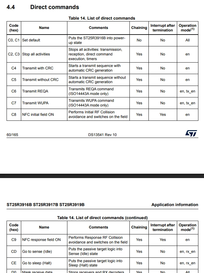

Due to our MCU has limited Fash / RAM size, we are considering to build our own middleware code to drive NFC frond end. but it looks like it's hard to understand the protocol through I2C waveform, and no any protocol document is avaiable on your website.
Is migating RFAL the only way I can do for realizing NFC function with 3916B / 3920B?

Andrew Neil
January 6, 2026
There's a list of commands in the datasheet:
https://www.st.com/resource/en/datasheet/st25r3916b.pdf#page=60
via: https://www.st.com/en/nfc/st25r3916b.html#documentation
Brian TIDAL
January 6, 2026
Hi Andrew,
The RFAL library provides an abstraction layer that eliminates the need to manage register-level commands described in the datasheet. Therefore, the use of the RFAL library is recommended: the same API can be reused on different products of the ST25R family without having to change the application code.
Rgds
BT
Andrew Neil
January 6, 2026
Indeed.
But if @LeoWu wants to write something from scratch, the datasheet would always be the place to start...
