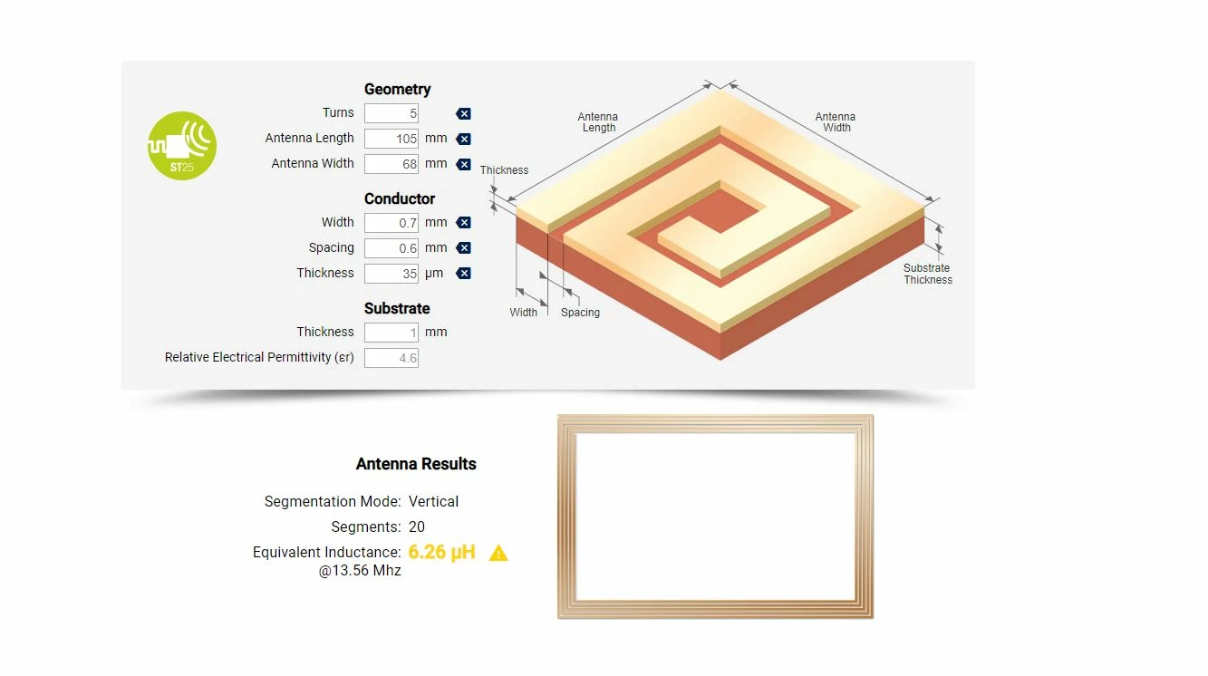

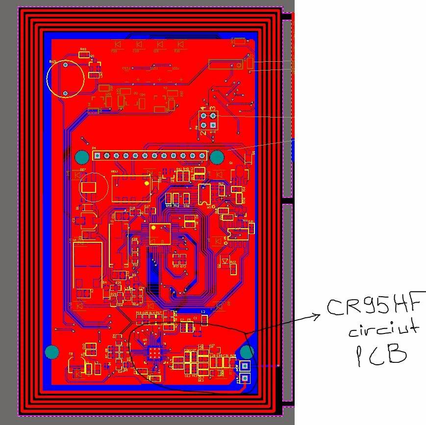

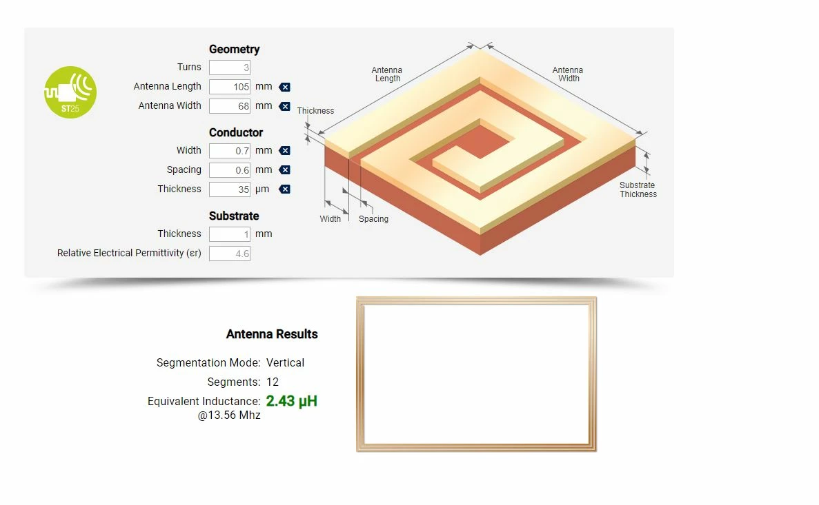

and you can see my antenna phisycal dimensions and equivalent inductance at photo3.JPG
at eDesing suite it dont seems a right antenna desing. gives warnings.

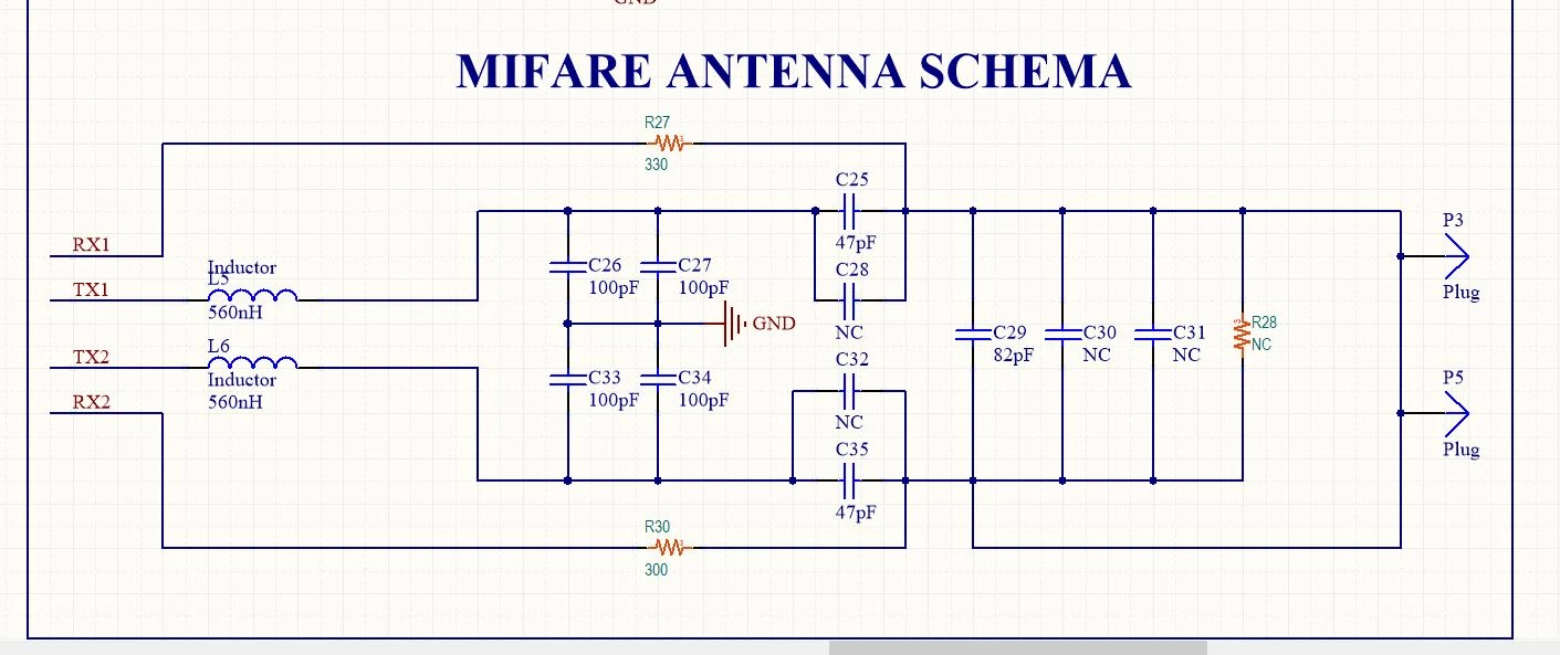

with below informations can you say me components values at my antenna circuit schematic at photo4.JPG .
if this antenna desing wrong, do you prefer me antenna desing at photo1.JPG?
if prefer ptoho1.JPG desing, do you say that; how must i choose component values and which components must be ? could say component values?

    Regarding AN5248, make sure to use the STSW-ST25R003 ST25R95 EMI filter calculation tool to easily compute the different values of the components. As your PCB has an important ground plate, the real electrical characteristics may differ from the theorical ones, so it is recommended to measure the actual inductance and impedence of the antenna and then use those value in the calculation tool.
    The antenna size is quite important. This may have some impact when reading tags having small antenna (in particular at the center of the antenna). Can you share more details about you aplication and about the tag characteristics?
    Other feedback from our RF expert: There is not so much room between the antenna and the blue part. Having more room would improve the performances. Make sure to have via between the ground planes.
